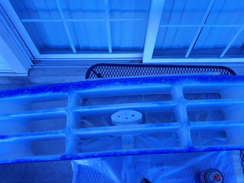

I'm replacing my bubbled and discolored chrome grille with a nice black one. I wanted to know if any of you have tips of safely removing the oval on the chrome grille and placing it in the black one? I'm guessing there's some sort of adhesive involved.

nope... take the grill off.. on the back there will be 2 10 MM nuts holding the ford emblem on..
see the holes???? 2 on the side are where the back of the emblem has threads goes through.. bottom hole is to line it up..
What Chris said.... A 30 second fix.
