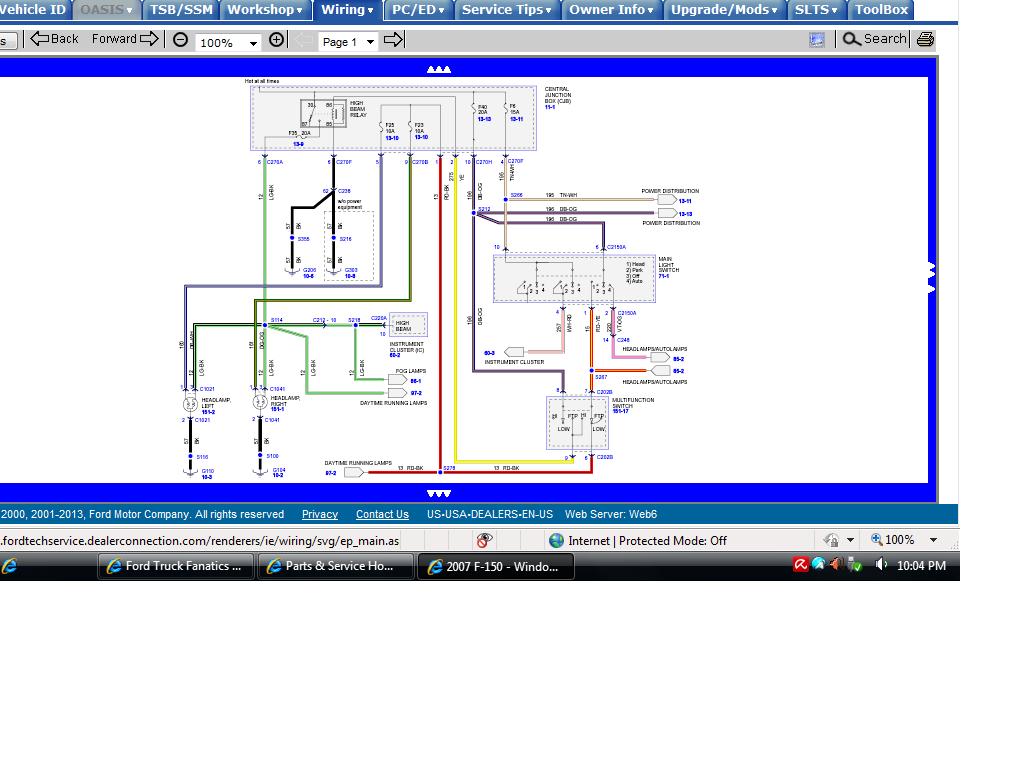

Oh hell I'm lost now. I'm not good with wiring diagrams. I did check I'm getting power in and out of the hi beam fuse and the high beam indicator fuse. I also had power at the high beam relay when I turned the MFS to dim lost power to the high beam indicator fuse which I think that would be right. It's almost like I'm not get anything out of the fuse box but something to do with this caused it to quit sending a signal to the fog lights I think they ground of the hi beam relay. The only reason I've got fogs is because I did the fog light mod that causes them to stay on with hi or lo beams

lower right of the diagram (multifunction switch or dimmer swith) Follow the yellow wire to the central junction box (fuse box). It energizes the relay. The black wire is the ground. The green wire should now be energized. That wire is both the high beams and the fogs. Be aware of the fuse in the circuit (in the fuse box).
