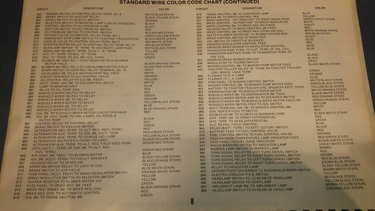

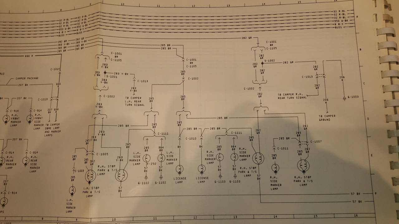

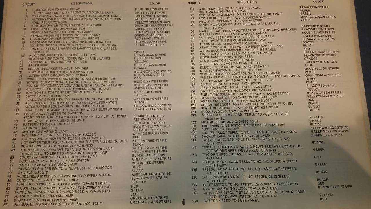

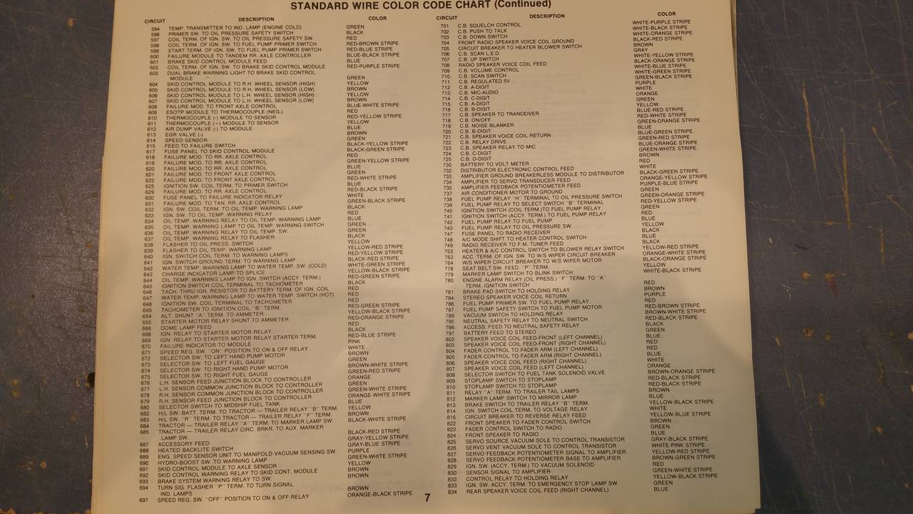

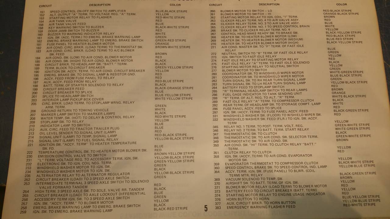

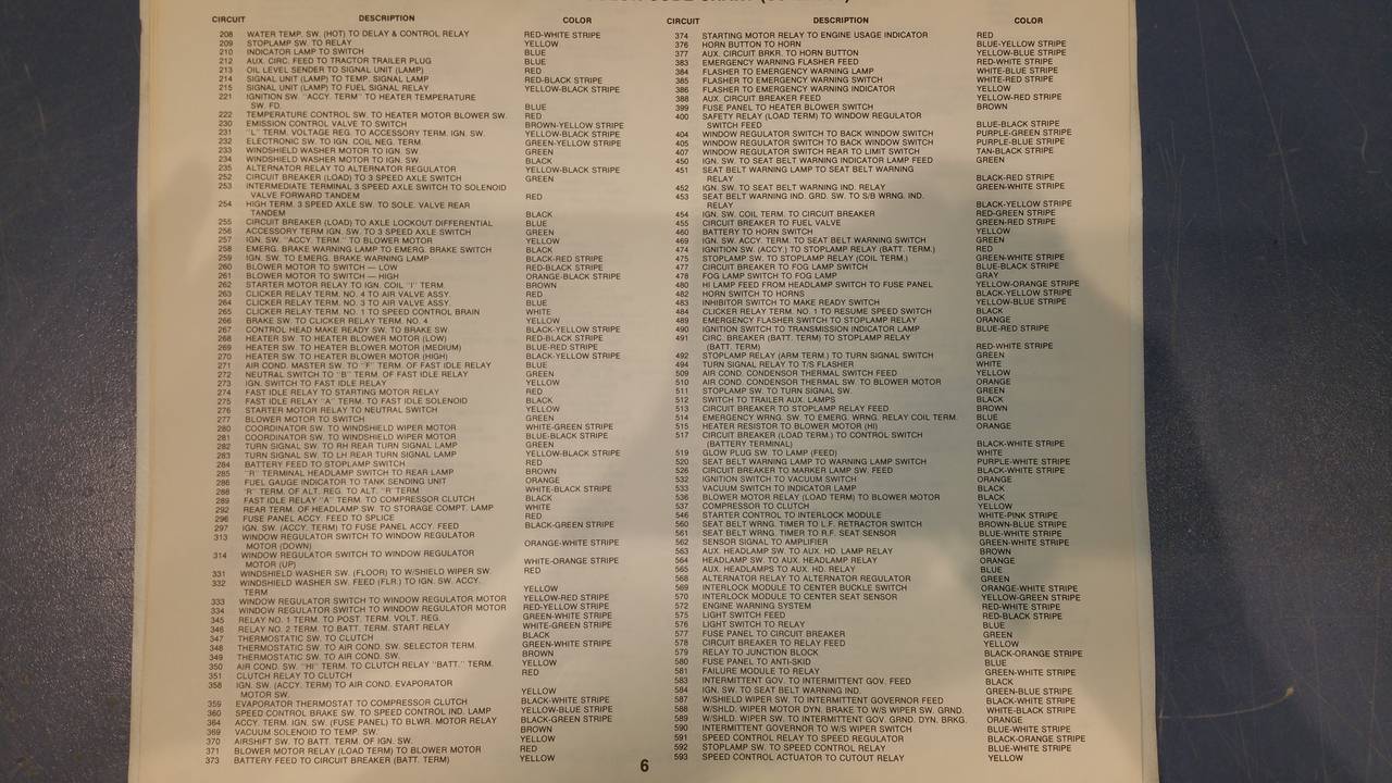

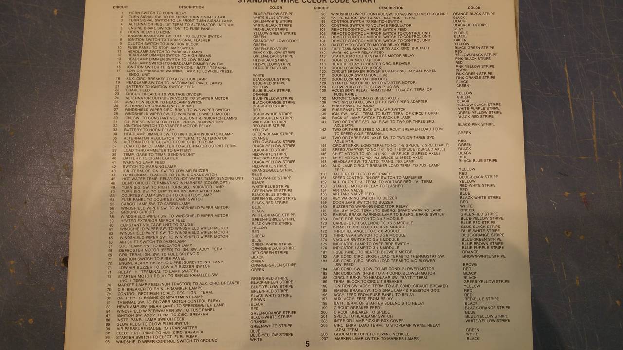

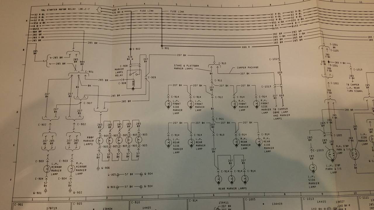

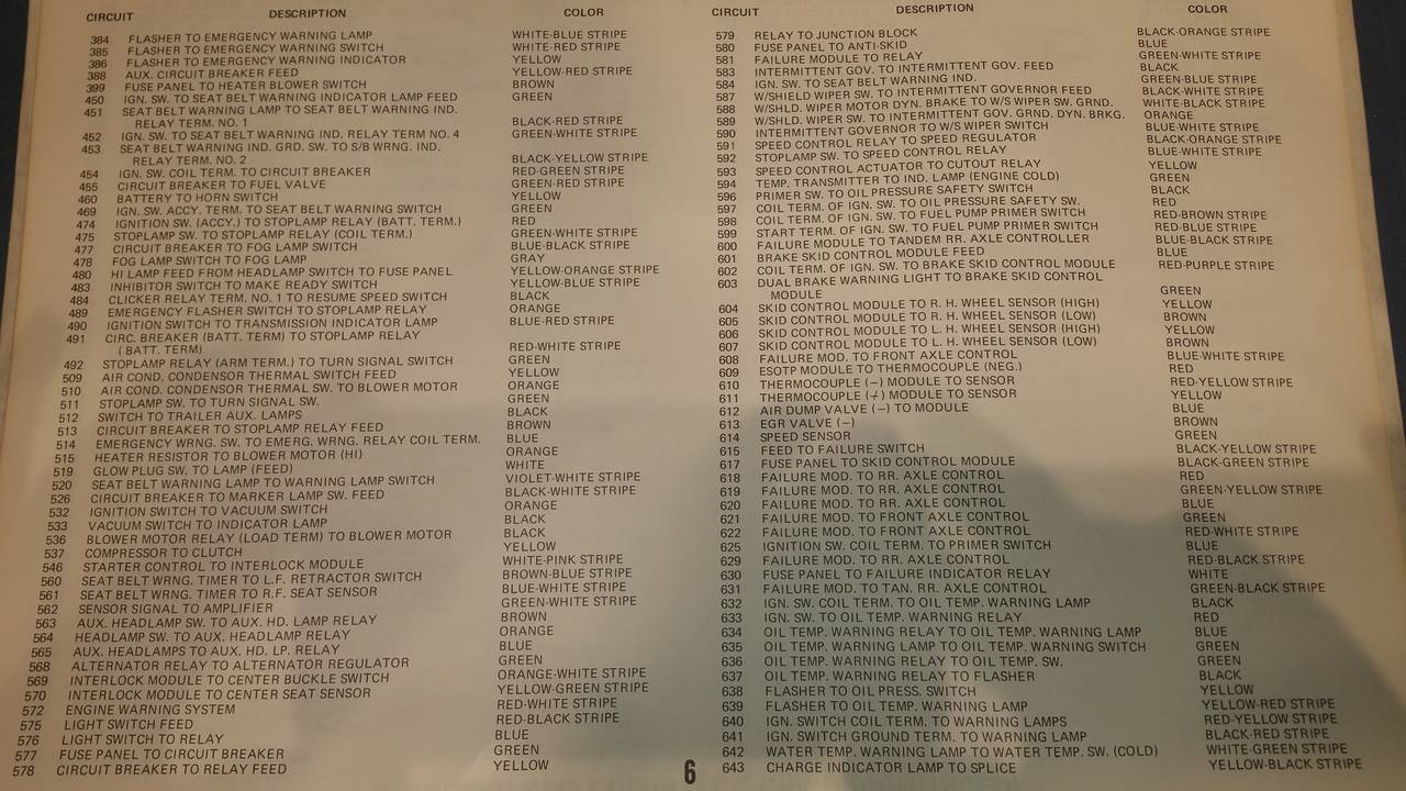

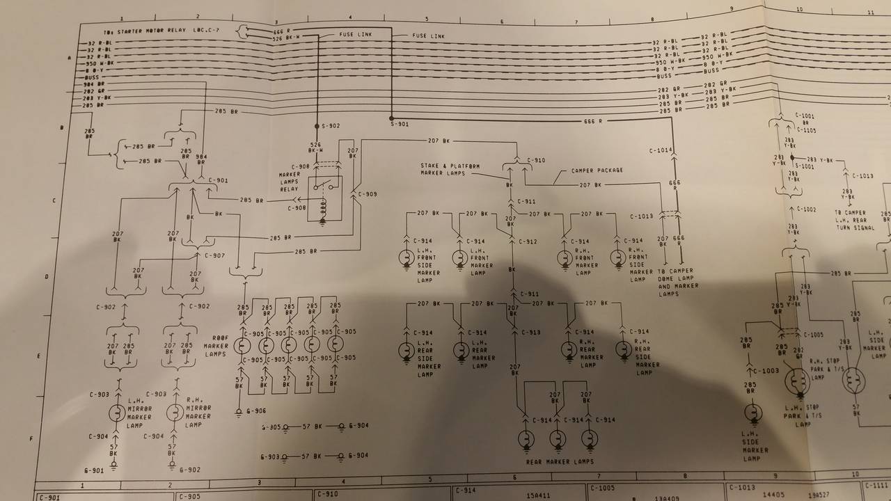

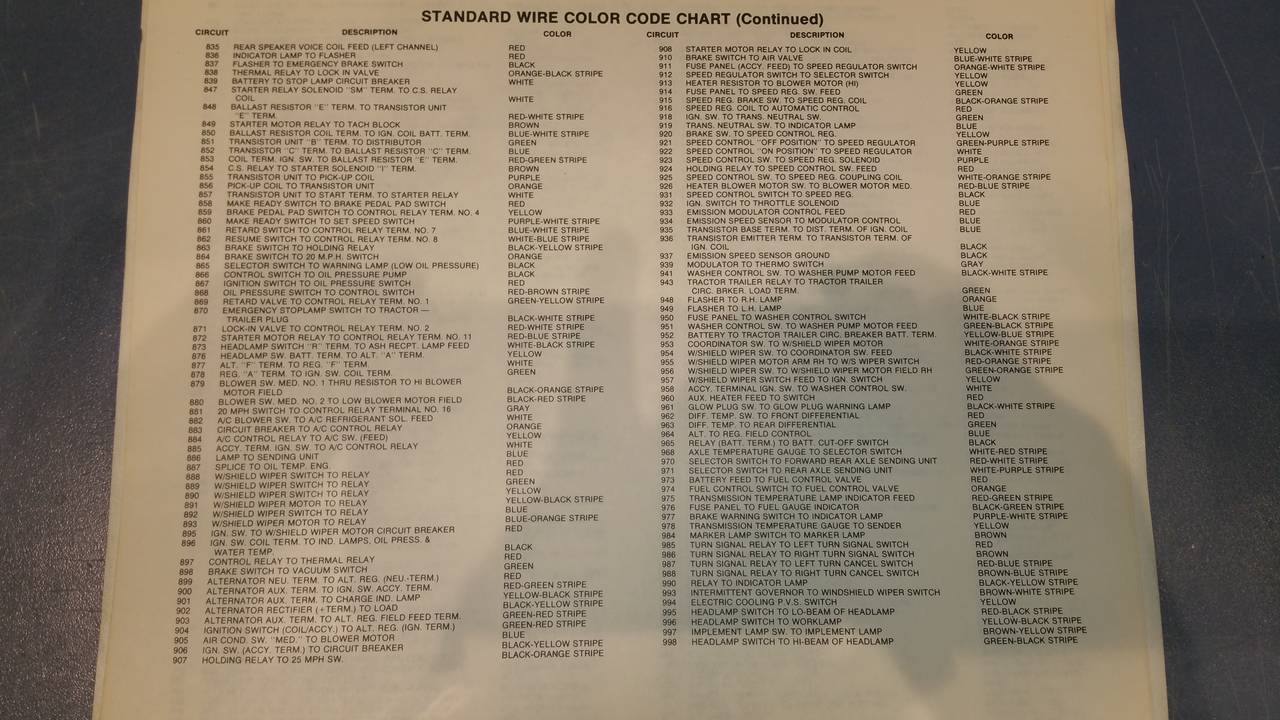

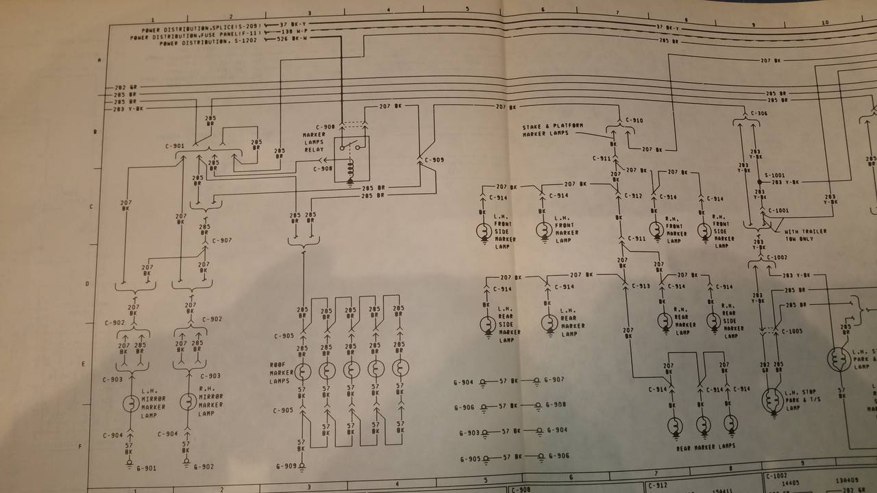

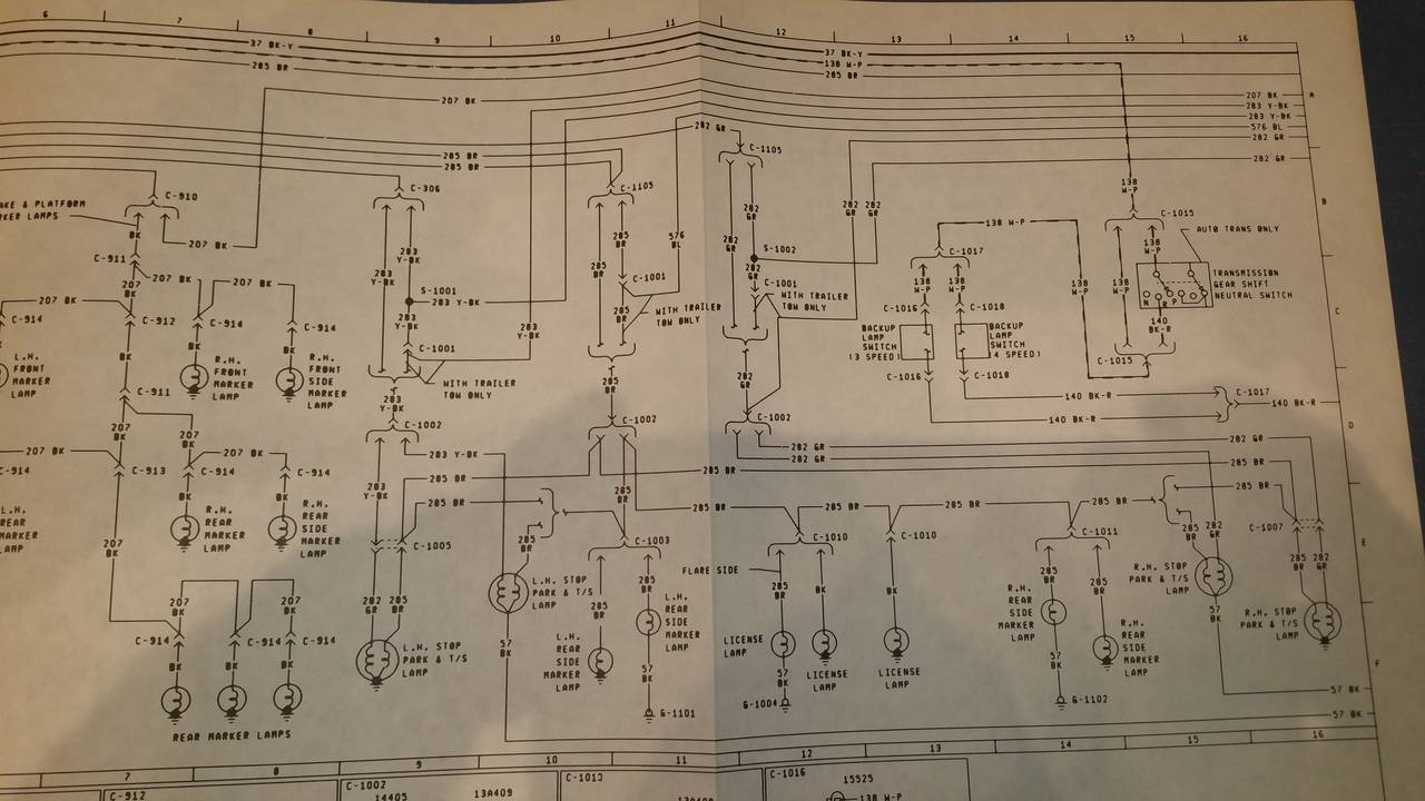

Hopefully the following images help.
The first ones are for 1976 wiring, there is the color code first then the diagrams...then the 1979 in the same order
1979
