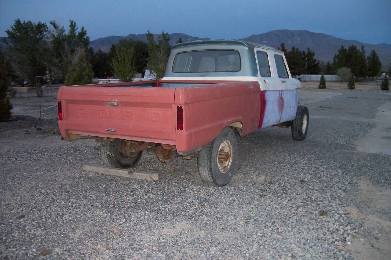

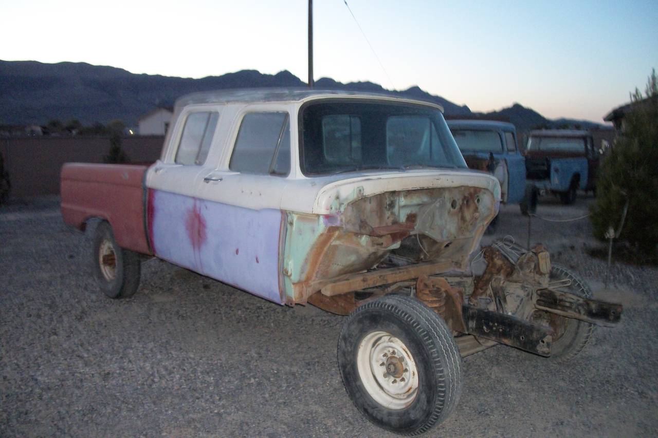

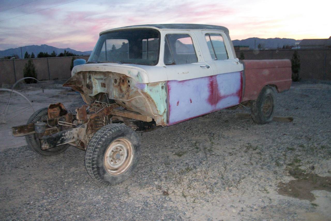

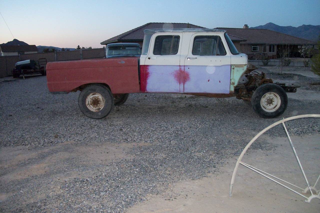

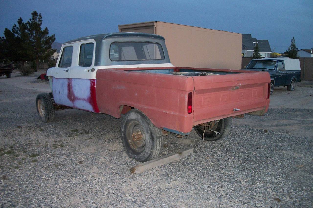

I have a basket case. A good start, I have most of the parts. The only rust is in the front where the front mount for the cab is. I bought a new set from Carolina Classics. I have to finish my 56 first. Working out of town limits my production but it will happen!!!!

I believe the first in house crew was in 65. Before that they were farmed out to other companies. Usually ones that have external door hinges were farmed out to other companies. If u notice the front wing vent is different from the back. I have found some of the 80's truck that have the same setup. I have the frame and bed sitting on 4x4 s. That is why the bed and cab look uneven. It sits on a F-350 late model frame and has the power steering and disc brakes. It has a swoop in the frame, so I will weld a piece of off set angle to the top to replicate the old frame. ( I have that also) Besides the cab has a total of 6 mounts. I am replacing the front cab mounts because they have some rust. If u r interested Carolina Classics makes a really nice set.
