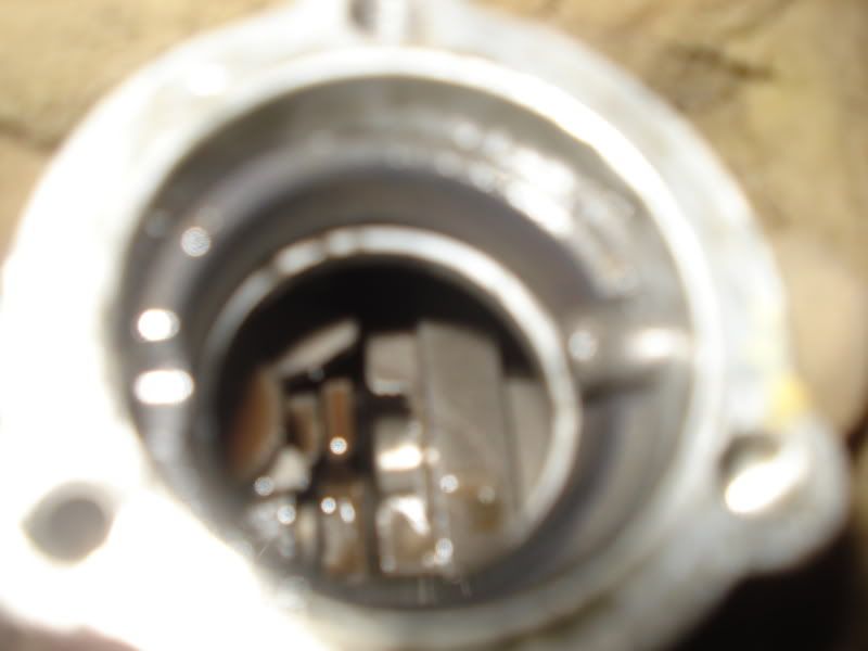

i was gonna ask that.. wait a sec here radialarm.. ill take a pic and you can point me in the right direction wait 5 mins pls
can you see the thing i need the move with this pic??
radialarm
Clown of Death!
Maybe the one on the left!!!
In neutral the two shifter slots should line up!!!
Like I said before it will only go in one gear at a time so which ever one will move is the one engaged!!!
Just move one put the shifter in and see if it will shift!!!

This is what it looks like in neutral!!!

ALLRIGHT!!!!! THANKS GUYS!! ITS IN!! thanks clown
