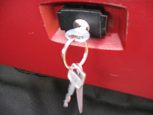

You can easily make your present key you use to unlock your truck work for the locking glove box latch you got at the wreckers :)

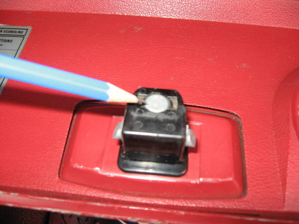

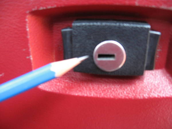

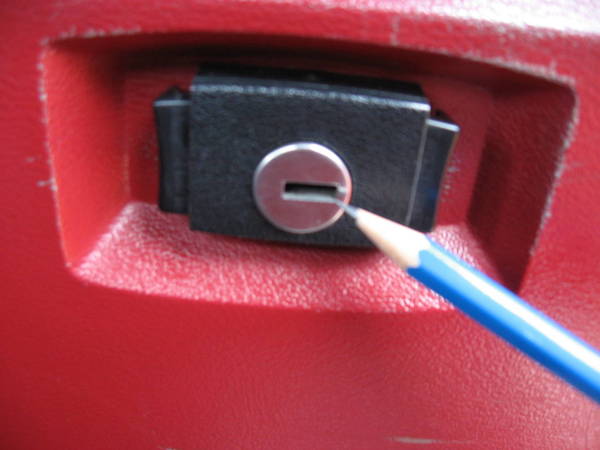

First, take note of the position the tumbler is in
unlocked
locked

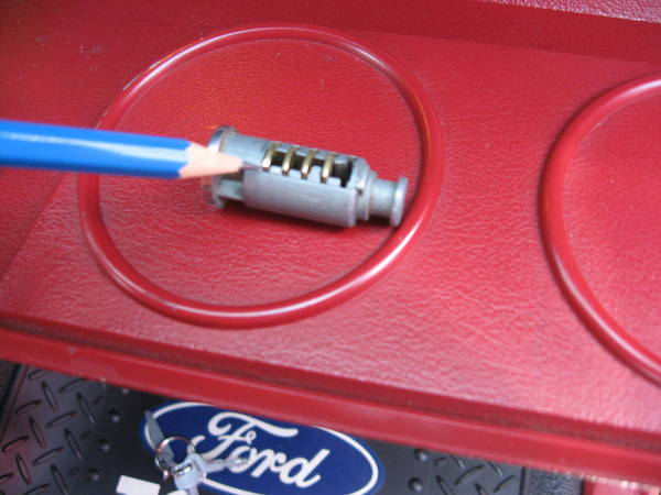

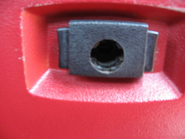

Two tabs hold the tumbler in place. Spread the tabs apart and the tumbler with fall out
Tumbler removed. Do not take apart the latch, no need to

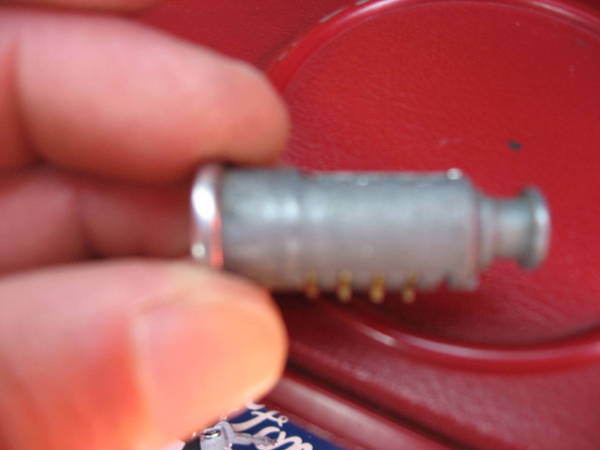

tumbler showing the "fingers"
tumbler shown without the key in the lock, "fingers" are Proud

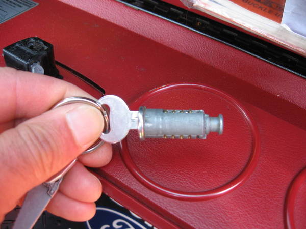

tumbler shown with key in lock, "fingers" are Flush with barrel

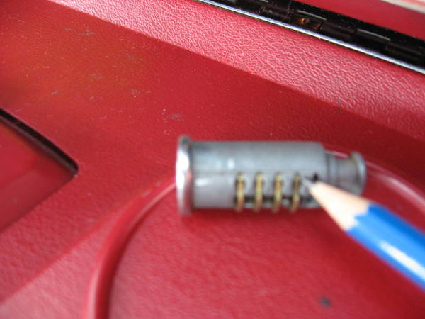

"fingers" that you need to re arrange to suit your key. Just pull out with your hand, there will also be a small spring for each spot, total of 5. Start with the first spot and put a "finger" in the hole with the spring and then insert your key to see how the action is. If it Does Not pull the "finger" flush to the barrel, try a different "finger". Repeat for each hole till your done. When your key is inserted, All "fingers" will be pulled in flush allowing the tumbler to rotate 180 degrees, locking the glove box door
and your done!!
