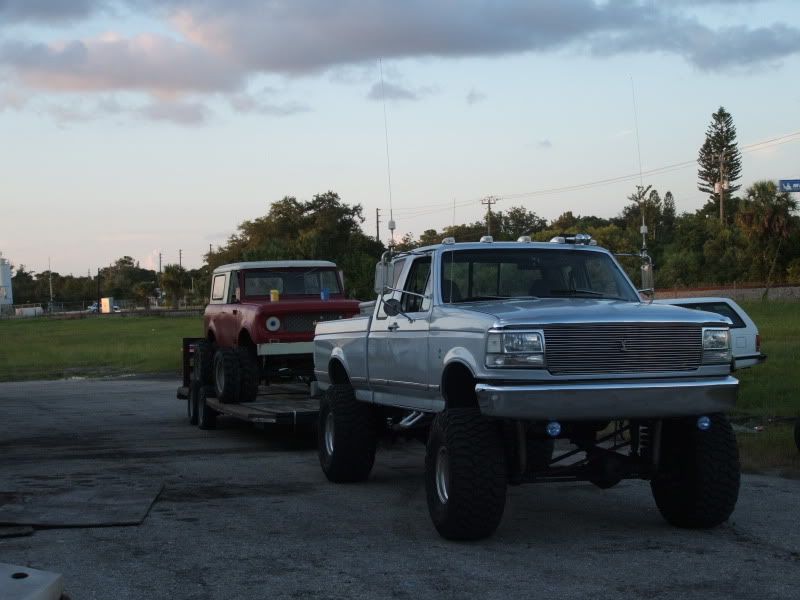

In this pic, I have about 750 lbs of tongue weight on the trailer. That took the *** of the truck down about 2 inches.

Well yours is a half ton aint it Tony? Chris itll still squat when ya get wieght on the back end either way. Its a half ton and they squat a ton cause theyre not meant to haul heavy loads. If ya dont want it to squat then get stiffer springs or get over loads. Its kind of a give and take deal how much are ya gonna haul with that truck and how often are ya gonna do it. Since your worried about the ride quality then id say just get the skyjacker ones that match your fronts. If it squats so what.
