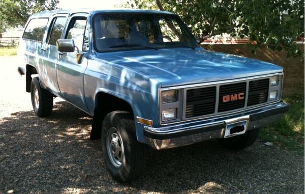

EDIT: Looking at my "before" picture... it really didn't sit that low before... and without the running boards it will look even better. The rear was sagging then but I replaced those altogether. I think I convinced myself to go stock height for now.
