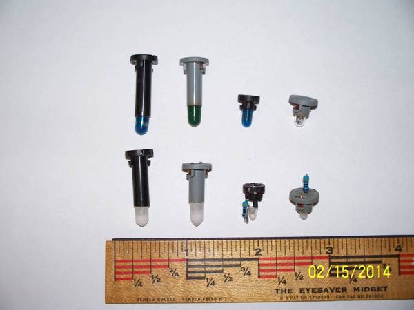

OEM incandescent on top, my LED builds on the bottom. Ain't they pertty! Reality is, you don't really want to know how much time it took to build the first one of each of those.

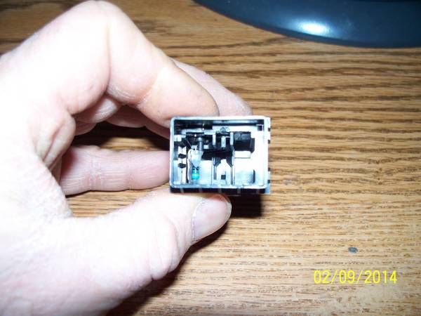

Verifying correct fitment and alignment of the new LED for the fog light switch. You'll never find that one for sale in a store!

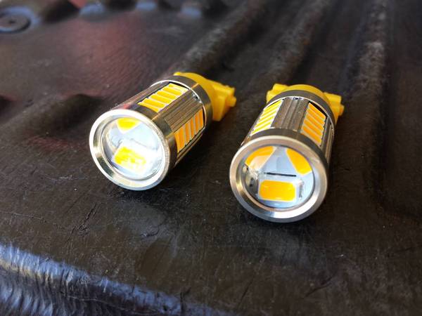

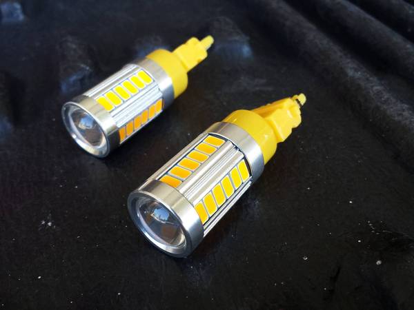

Well here we go again, after researching and comparing available options, I ordered and installed a pair of these in the front park/turn light. And the result is simply outstanding, the pattern is so close to OEM and the difference, if one can distinguish, is so debatable that it's effectively impossible to tell the difference, and response time of the LED's really makes them stand out. On the light pattern, yes it is true that there are Federal Standards for visibility of all the exterior vehicle lights as well as state laws addressing them. However, if a person really stares at their lights and thinks about it, then looks at the lighting on other cars, it's easy to see that there are all kinds of cars out there with all kinds of variations.......and surely, as OEM, they complied. Common sense goes a long ways in guiding a person into the right LED for their application. Here's what I used:
