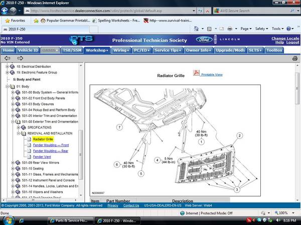

Removal
Remove the 7 pin-type retainers from the front radiator grille.
Remove the 2 bolts from the radiator support bracket-to-radiator grille.
To install, tighten to 5 Nm (44 lb-in).
Pull up on the radiator grille, working from one end, and release the radiator grille retaining clips from the hood.
Remove the radiator grille.
To install, reverse the removal procedure.
