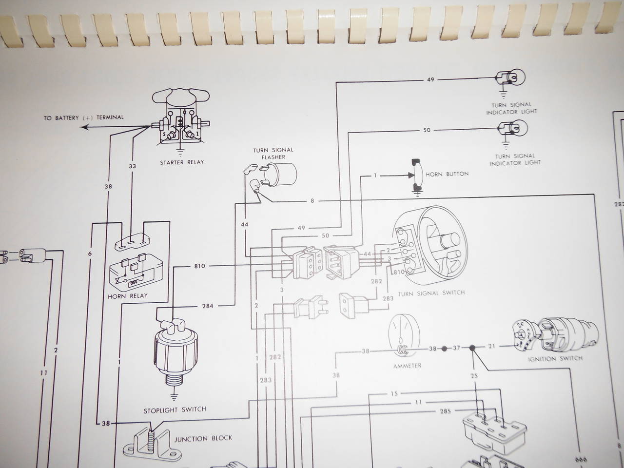

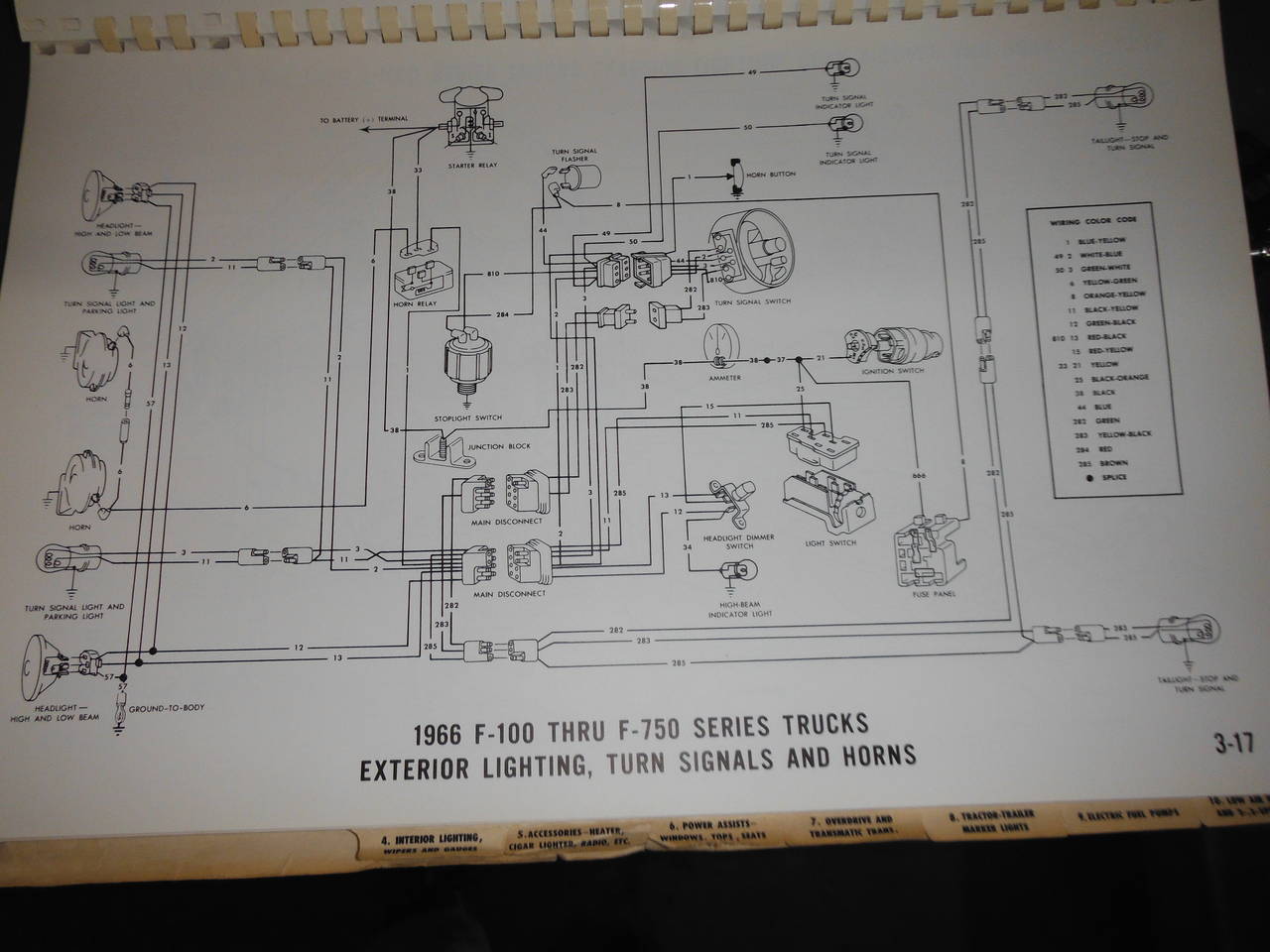

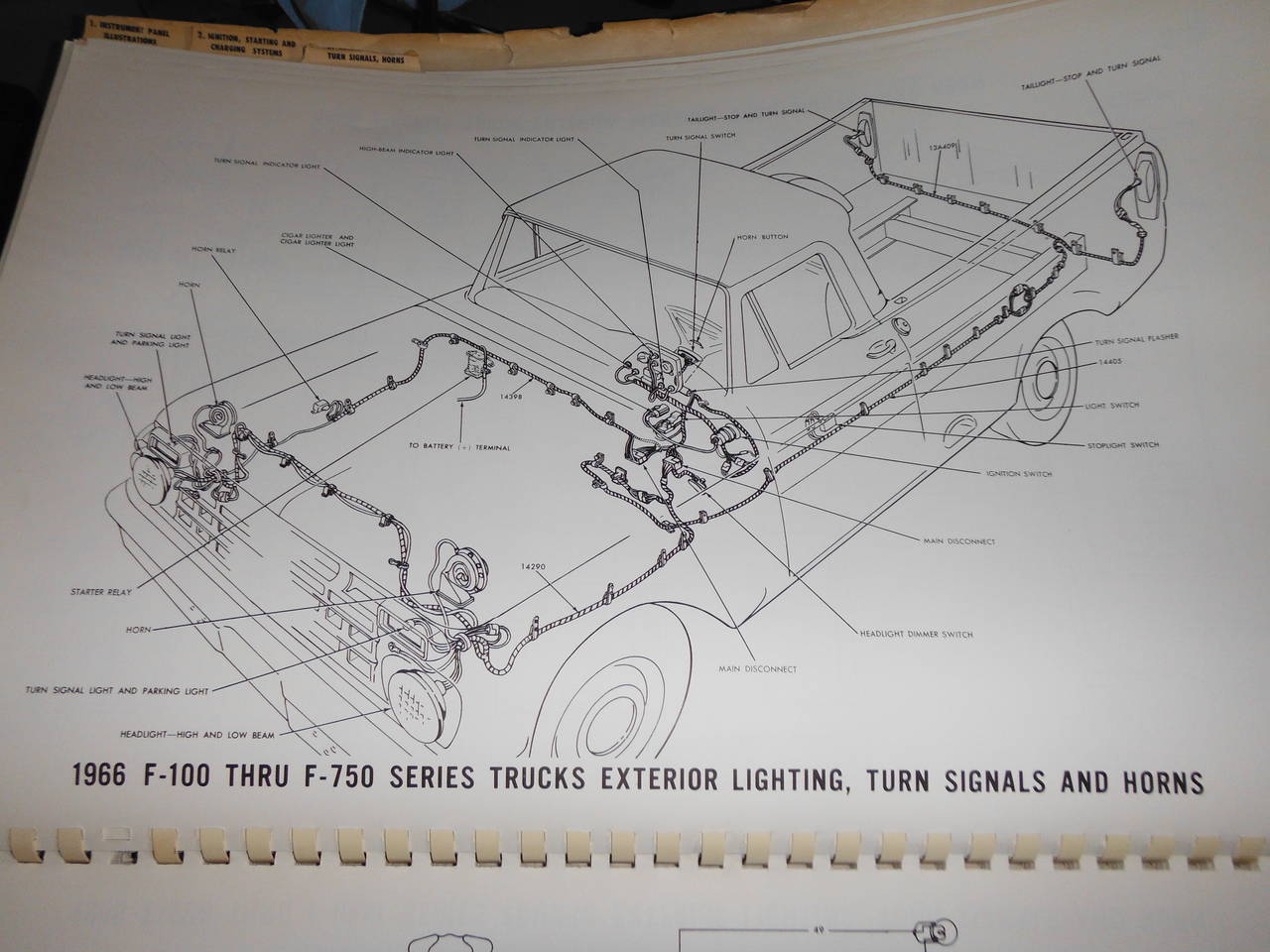

Picture incoming....the button on the steering wheel closes the coil of the relay.

Thanks for the scans but I have a wiring diagram but don't understand the symbols within the horn relay to know what is going on. I found another confusing thing in that the wire (No, 1) at the horn contact within the steering wheel changes to a No. 2 and then back to 1 and then back to 2 on its way to the firewall harness connection. I have worked on 65 and 66 Mustangs which do not have horn relays. If someone has a better idea on how to trouble shoot a horn problem I'm receptive to anything.

It looks to me that #1 goes all the way through.
The squiggly thing inside the relay is the coil and the XX looking thing is the contact...in this case normally open...when the coil is energized by the horn button completing the circuit, the contacts close sending power from the solenoid terminal to the horn.
Take a test light and see if there is power at the horn button on the wheel and work your way back to the relay.
