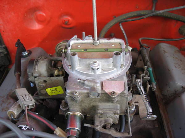

This is the original carburetor.(still has the tag on it).
Save your original carb Doug! and get a new one. Wish I had not done the core exchange with mine :( the saving grace was that I got one from a truck that had just come in and it was the original with the tags still on (see my gallery) so I was happy again :)
