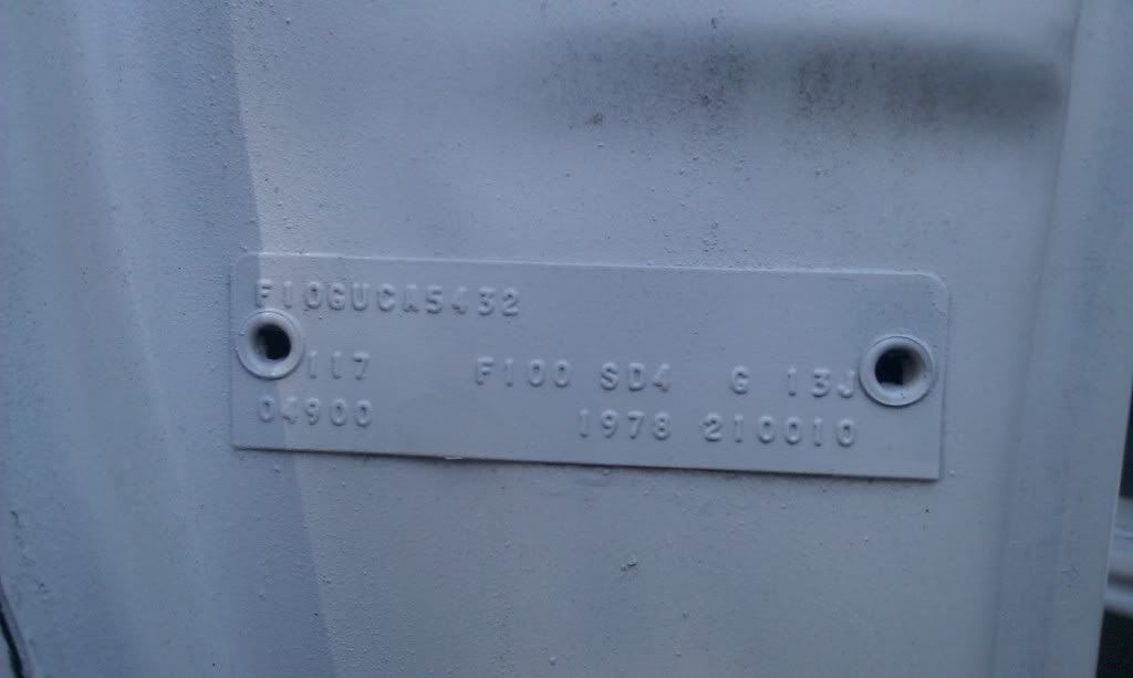

First off, on the driver's door plate, the paint code is completely blank - not rubbed or worn away, there was never anything there. Seen some places tha that could mean it was a custom color order but not sure; if it was custom ordered is there a way to determine the original paint color?

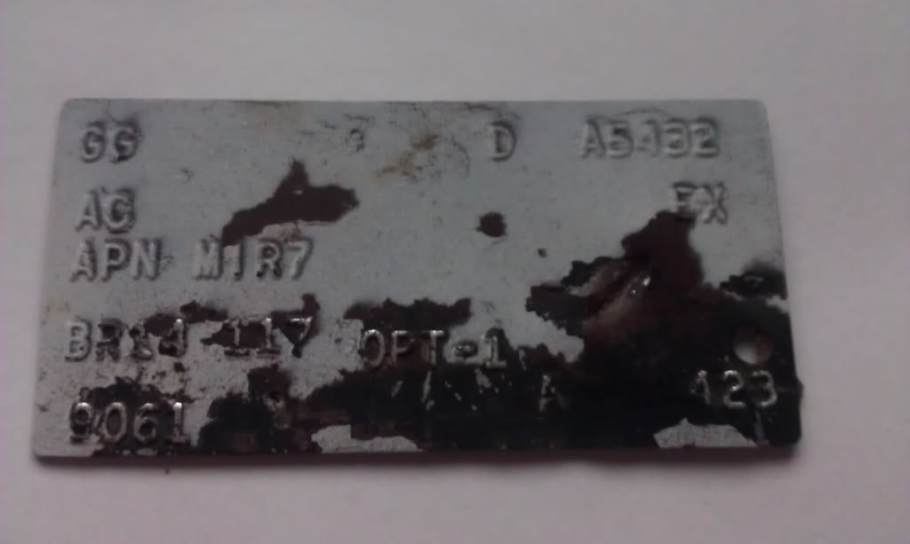

Secondly, I can't find any info to help decode the data plate on the passenger side of the bed (or even any site that references the existence of a data plate on the bed?) which is laid out like this:
GG D A5432
AC
APN M I(or 1?)R7
BR14 117 OPT-1
9061 423
Some of the above numbers/letters could be "off" since it's kind of in an odd position and has been painted over at least once.

That looks more like a Buck tag, than a vin tag. Buck tags were used for line employees to determine what was put on the truck when it was built. My Buck Tag is listed below.
F14SPBE8145 14-279
SX 133 BDY 4 BAR D
1C MLD LAR RCE TD
A XCJ P 6 93 BOTH
Photos inside and out would help .
Is there 6 digit number under DSO stamp ?
There are only a couple of us on the internet that can decode buck tags,
Is there a buck tag still riveted to the firewall ..top - middle ?
see mine behind the air cleaner ?

There is a vin decoder in the Gen 6 subforum specifically for the 1978 model year.
F10 - F 100 2WD
G- Engine code 302 2 bbl
U- Manufactured in Louisville, KY
CA5432 - Manufactured April, 1978
G - Automatic transmission(Guessing a C4 since is an F100)
13J - 3750 lb axle - 2.75 ratio with power steering
21 - DSO for Atlanta GA
0010 - No idea, but guessing a special order number, since it is listed after the DSO code
4900 - GVW rating of truck

http://i1015.photobucket.com/albums/af276/jenn4sale/78 Ford/buckplate.jpg
This truck was special ordered 210010 means the 10th truck to be ordered in that DSO 21 region
I'll answer the codes info in pieces
The D before A5432 is the truck paint color = RED
SD 4
S = Seat type= Broadcloth and vinyl bench
D - Red In colour
4= Styleside box
117 = wheelbase 117"

Just remembered something else the 210010 in the DSO means
to find out what modifications were done to it you have to look
that up in the records because that number by itself means
nothing. But we know what Bill's "nothing" means. Means "almost
nothing" LOL :) Because the 21 does mean DSO "21" ...right? :)
It's like you say and what Bill means by "nothing" is that it's just
#10 that was shipped to another manufacturer for some sort of
work. The example on FTE was a 4wd F350 modified by Gordan
Moody. {it can prob'ly still be "searched up" on FTE}

Trucks that were made for dealership lots didn't have a 6 digit DSO special order number.
Trucks that were specially ordered by a customer that the dealership couldn't piece together received a Ford Factory Purchase order number (they aren't usually more than 6 digits long) to keep track of the truck from start to finish in the assembly line.
There is a difference between dealership inventory order and a customer order.
Think about it, How many actually truck in the Atlanta district would be specially ordered with so many options available compared to a dealership adding or subtracting items to please the customer.
The highest special order number I have seen anywhere was about # xx1850

Well if you go into a dealership with a list all your requirements and they can't supply you with a vehicle with all of most of them, they will have no other choice but to specially order it.
One thing back in the 70's was that some paint colors was only available for cars.
This was the major factor in special orders.
BKW

Data plate with missing paint code:
The COLOR code is blank because the vehicle was painted a non standard color per the original purchasers request.
When this occurs, this makes the truck a Domestic Special Order.
DSO: 210010:
21 = Atlanta GA Ford District Sales Office, where the original selling dealer ordered the truck from.
0010 = Domestic Special Order Number. The truck was ordered special, not "bought off the lot."
For further info, contact martiauto.com. Marti has ALL the original records for 1967/79 FoMoCo vehicles.
Alvin: A vehicle that is ordered with all RPO's (Regular Production Orders) is not a Domestic Special Order.
In 1979, I had to order a new F150 Lariat S/Cab, because I wanted it tu-toned Red/White with A/C (and a lotta other jazz). The dealer I worked for was unalble to locate one, that could have been "dealer traded" for.
btw: After 1972, F10 decodes to F100 2WD Pickup.

No, because like your truck, everything was a Regular Production Order. I had to order it because I wanted tu-tone red/white paint, AM/FM multiplex stereo, factory A/C, and other options.
Since the dealer didn't have one, and none could be found within 100 miles that could be "dealer traded" for, I had to order it.
Only if something is ordered that is not an RPO, is the vehicle as Domestic Special Order.
Special non standard paint, back of cab equipment like a utility body, flat or stake bed.
The DSO is necessary if the paint formula is required, or parts are required for the back of cab equipment. None will be listed in the parts catalog, so the dealer contacts FoMoCo, passes along the 6 digit DSO.
FoMoCo looks up the order number, then tells the dealer what the paint formula is, or where to get the parts for the back of cab equipment.
This same system has been used for decades.
