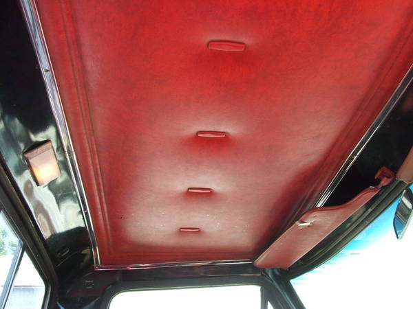

Here is a Lariat Headliner. The only real differences are the tufted attaching points, chrome trim, and extra insulation underneath for sound deadening.
^^^I was thinking of a potential black leather wrap...not sure if I'd go with a standard grain or go with a diamond pattern. I have the trim, but it just borders the particle board.
