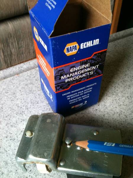

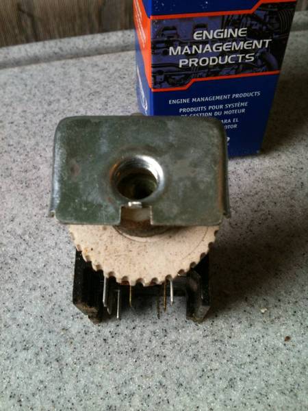

Not sure about earlier trucks, but for the '83 the replacement switch comes without the shaft that the headlight knob fits on.You have to remove the shaft from the old switch by pushing a little button on the housing and the shaft will pull out. Then you push it into the new switch till it "clicks" into place. I'll post a picture of the old switch for you.
Ok Doug, here's the pic's :)

Oh, lets see if I got this right, the chrome knob that slides on the shaft? The new switch doesn't come with the shaft. You have to use the original so I had no problem of the headlight knob not working. Sorry if I still haven't answered your question properly Doug, ack!
