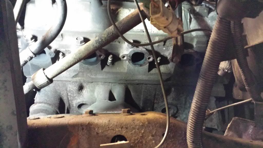

So I decided to finally throw the headers on. The bolts were in perfect shape for being in the east coast. I think they were replaced with the manifolds at some point. But on each side there are 2 bolts broken. So I with people stopping buy, and running for supplies during the day. I got 3 of the 4 drilled and tapped. Also the drivers side is in and back together, and modded the dipstick tube to fit.
