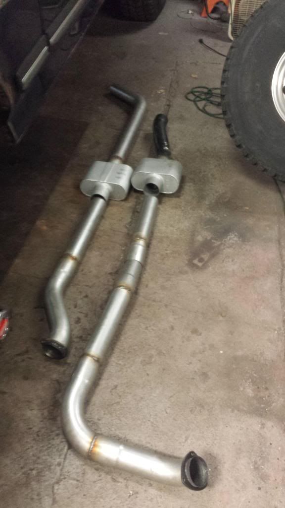

Headers. Custom Dual Exhaust 7.5L
Hedman Mids, Flowmaster universal 3" Kit, Single Chamber Flowmaster
Hedmans came with nice y pipe but wanted dual so I just borrowed the sockets for flowmaster pipes.
Mocked Up
Installed Fully Welded, And yes, there is a O2, and yes there are hangers you just cant see them!!!!
Just gotta finish up some mods as well, adjust the box while its in my face, and remove the air pump....Gotta order tips now, and PS it sounds BAD AS HELLLLL
I really wanted long tubes, but the ZF doesnt allow for that, or at least I didnt see anyone trying long tubes
Why yes, yes it does. :) I used the Hedman y, and split it back into duals with the same muffs and 3" tail pipes. Mine has that late model smoothness, but it`s loud, and MISTER, when I`m giving her the shoe, ye old 460 sounds ANGRY, and I like it. I yike it a yot.:wavey:
Yea I also removed the smog pump, and all the related garbage with it. I even adjusted the PS box while I had the wheel well out and holy hell the steering is so tight now. That truck was so lose before. Haha
