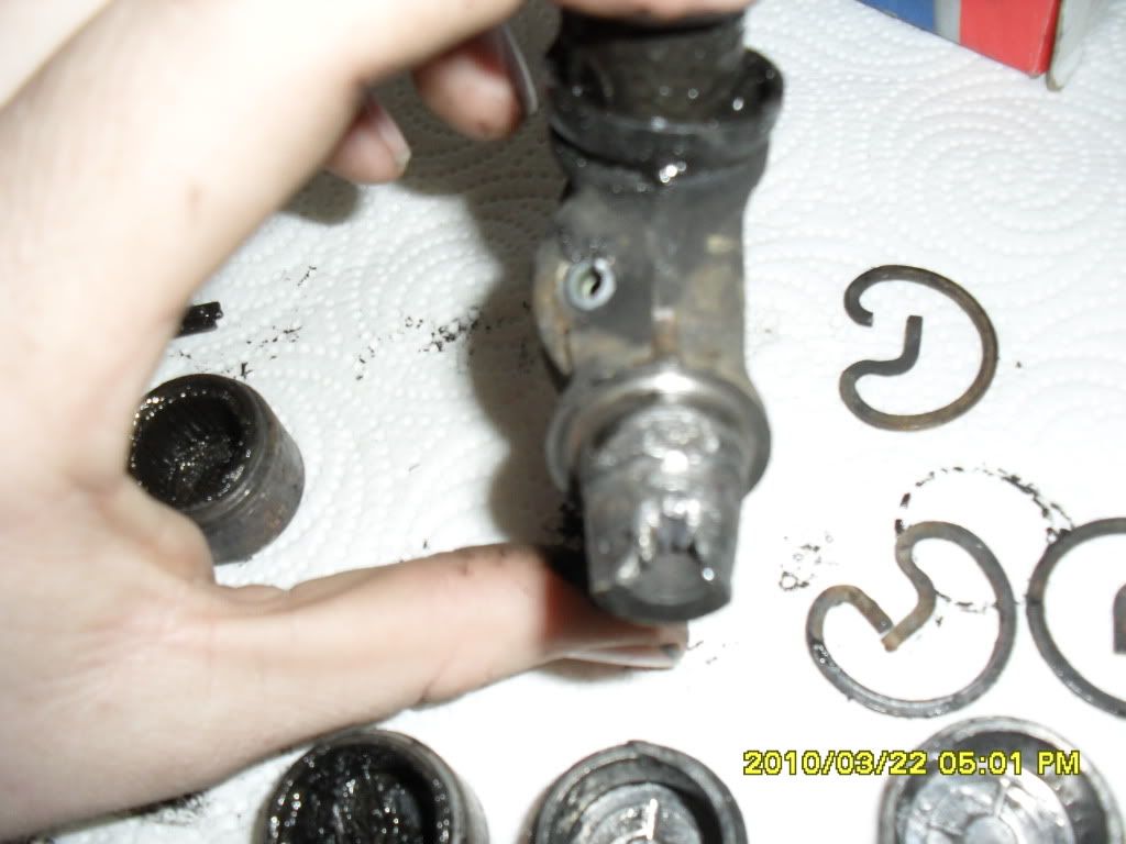

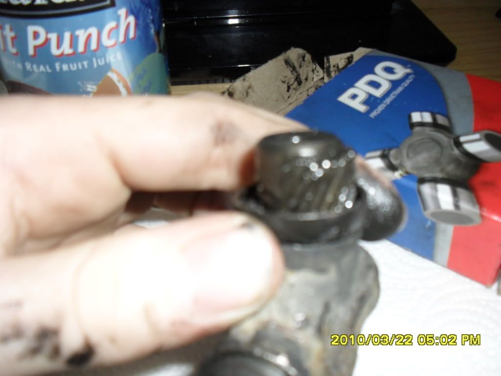

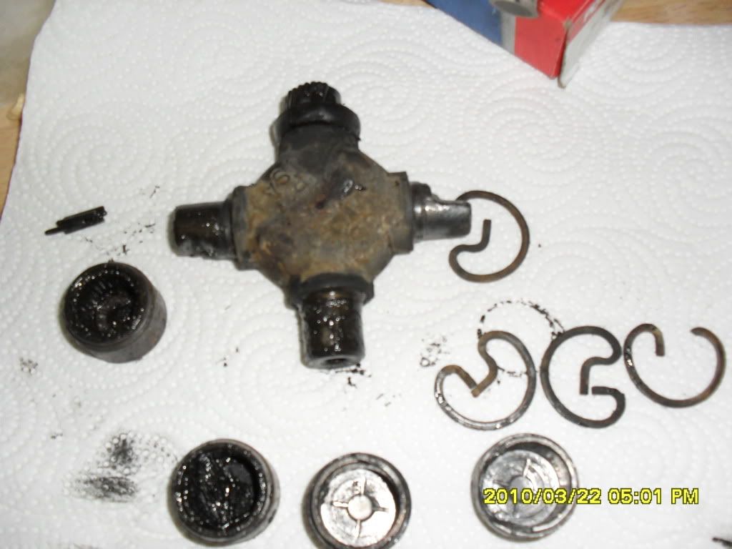

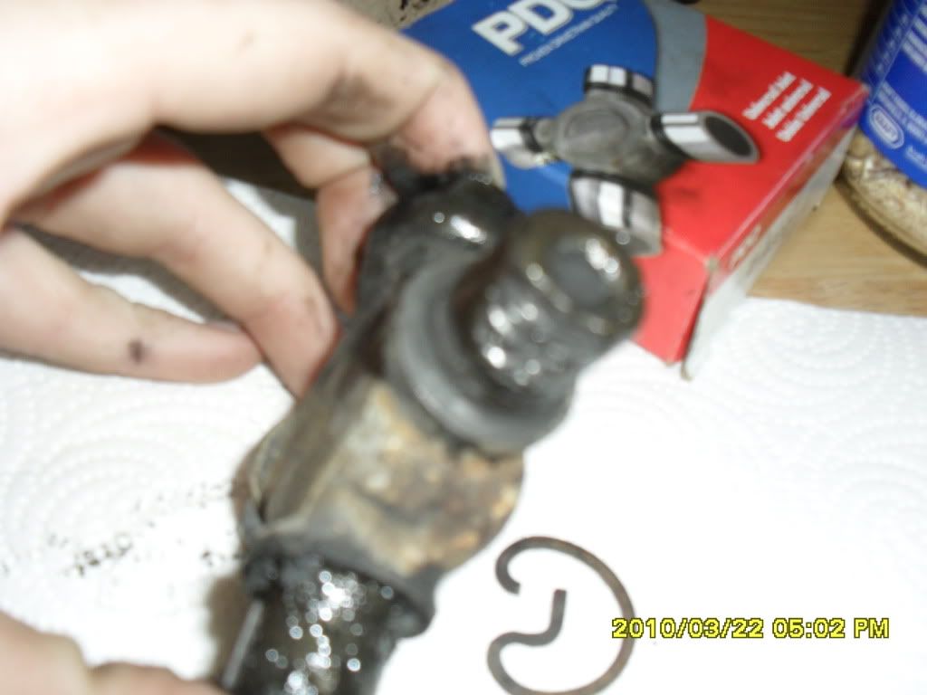

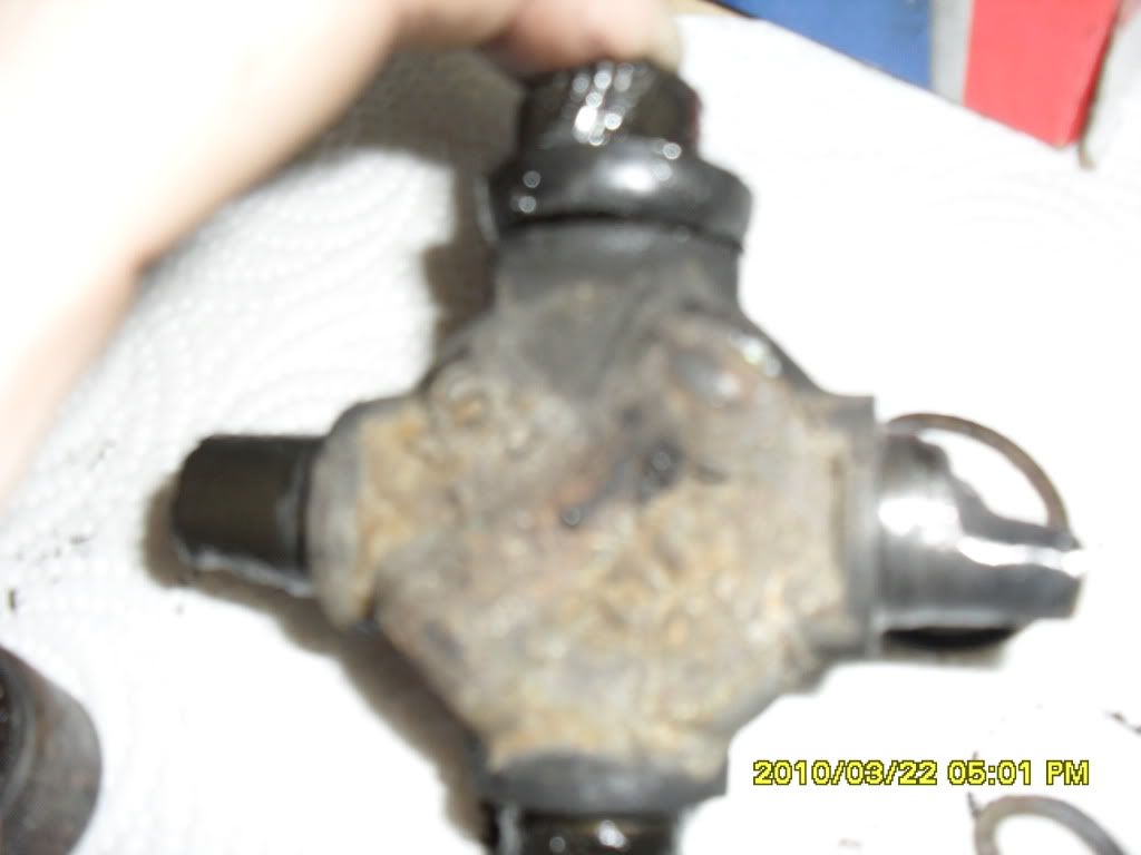

hallelujah!! my vibration is fixed finally!!!!
14,464
384
and it was the god danged U-joint! the rear one. i finally gave up trying to fixed it on my own and took it to transmission masters.. the only drivline shop i trust. and told them what all ive done and they said what bout the u-joints? and i said they felt and appeared to be fine. and didnt feel any play in them they drove it and then checked with some special tool and guess what they found.. the rear u-joint was basically toast. they said it was to unsafe to drive it couldve completely broke at any minute. heres the pics to prove it.......

Jacking the rearend up is a new one for me too......that u joint ain't bad...little bit of sculpting with some JB weld and then perfecting it with a die grinder ....woulda been brand new again! Advanced auto parts FTW!

Yeah next time ya check em put the park brake on and put in neutral then twist the driveshaft back and forth like your goin from reverse to drive.
