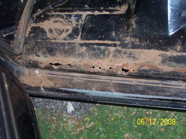

Pulled the original carpet out of my truck last night to get a good look at the flooorboards. I have a 2" diameter area of rust on the drivers side by the fornt of the door and a very small speck on the passenger side. The rest of it looks brand new. Should be an easy fix, I'll get pictures tonight and post them.
A little worse than I thought but I have seen much worse.
I did not see the rust until I pulled the rubber for the door out of the way.

Very common spot on these trucks for rust. The problem was the juke backing on that carpet holds a ton of moisture in it.

Been there done that . I used to throw those braided entry mats under carpet in winter ( I know I would run a 79 now in snow) To help breath .
But your is not bad at all.

After I replaced the drivers side floor pan in mine, I blasted the inside and underside of the floor, than had it completely rhinolined. Hope it keeps the rust away for quite some time.
