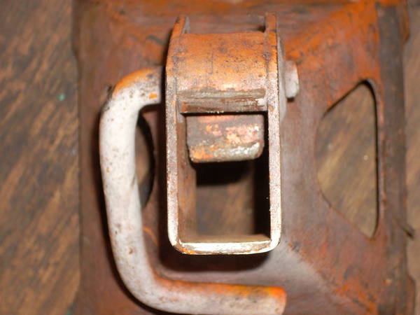

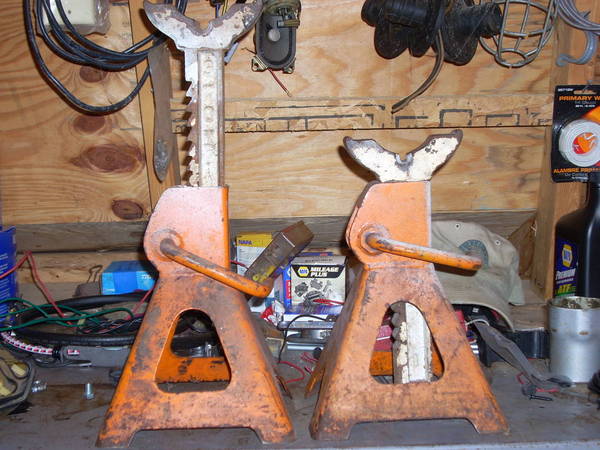

Im my Gallery of pics are two pictures of a very safe 3 ton rated jack stands.they are constructed of heavy iron & the saddles are cast iron.the handle at the neck is the release handle for the adjustable saddle.when the saddle is raised it will interlock with a heavy duty tab that is attached to the handle in the neck of the stand.they only release when the vehicle is lifted from the stand by lifting up on the handle.as you can see these units have been used a long time & ive had them well over 10 years,these stands are suitable for PASSENGER cars,vans,pickups.bigger units are available for the real heavy trucks{heavy equipment}i got these units at harbor freight,shortly after one of my department store stand folded up on me one day while changing a tire.been there done it i wont repeat it.
