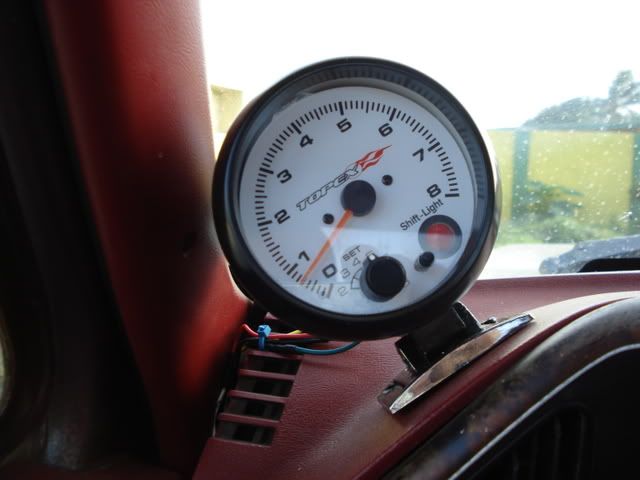

they dont make 3 guage pods.. for 1987 -1991 generation... dunno why..
i dont think the 92-96 generation will fit..

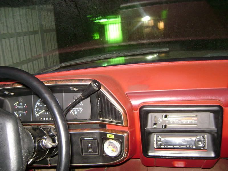

and i have my rpm here so there isnt any room for a 3 guage pod and y prefer a 2 gauge pod....
here is my rpm the pod is going a bit higher and it will look just fine :) since y already have my water temp guage nex to the overdrive button
yeah bud.. im going with the mechanical guage:)
