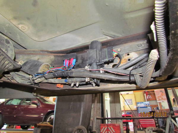

You'll need two 12v 5 pin relays and wire them up just like this diagram which i modified to show how i did it - switching from tank to tank will reverse the polarity changing the position of the valve.
Finally got it finished - my truck has plastic fuel lines which i will eventually be replacing as they are starting to get brittle .... i used some rubber fuel line (5/16 and 3/8) to join the lines to the new valve as the original fuel connectors aren't compatible with the Airtex barbs. You'll also need to fab up a mounting system for the Airtex valve as it won't mount directly to the chassis rail - stupid thing mounted on a 30 degree angle ..... i just used a bit of flat bar and bent it then drilled two holes to suit the valve mounts and then drilled two holes in the chassis to bolt the flat bar to.
