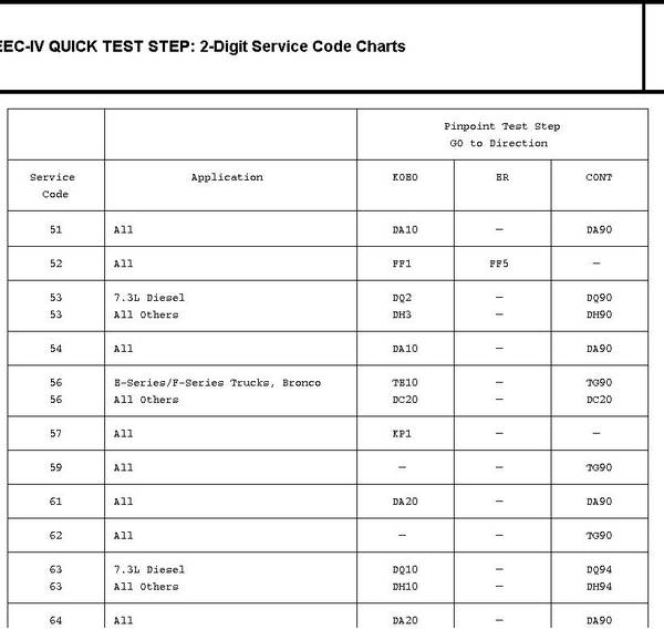

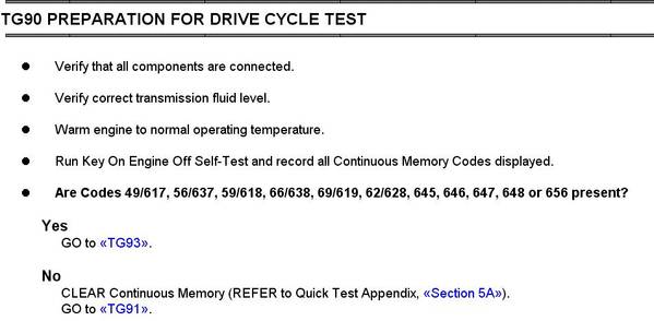

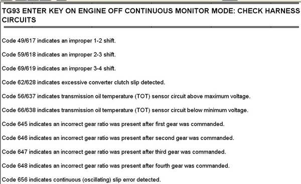

The 33 and 62 codes are not KOEO codes, they can only be CM or KOER codes and you do not know how to run the KOER test they would have to be CM codes..
The 62 code indicates excessive converter clutch slip detected.
The 33 code says the EGR valve did not open. Vacuum problem or the sensor on top of it as said above.
The 67 code says your A/C was on when you did the test.
Bill the 62 CAN be a KOEO code...
But I just noticed that he specified what kind each code was:
fadedf150 said:
The codes came out as KOEO 67, CM 33, 62, 67.
Sorry it looks like you are going by a bad chart.
Here is an image from the FORD shop manual.

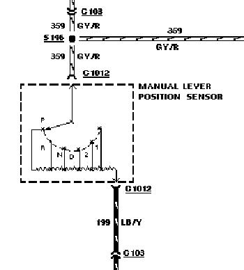

What else does the nuetral safety switch do?
Mine works fine as far as only letting it start in P or N. Reverse lights come on when they are supposed to also. What else would trigger this code?
Is it even the right description for that code?
973
11
Neutral Safety Switch:
"This switch opens (denies current to) the starter circuit when the transmission is in any gear but Neutral or Park. Standard transmission cars will connect this switch to the clutch pedal so that the starter will not engage unless the clutch pedal is depressed."
I take it you are asking what does the MLPS does on the side of the transmission as far as the transmission is concerned.
It changes the voltage going back to the computer to tell the computer what gear is selected.
