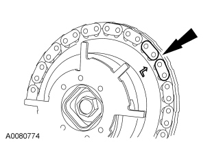

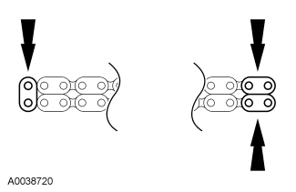

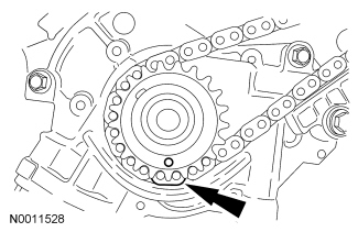

If it has to retard the timing to make it be where it's "supposed" to be then when it accually needs to retard it during normal operation it won't be able to because it's already used up its "travel" on the gear if that makes sense to you. If this were my truck I would be pulling the timing cover and rechecking my base timing I know its a pain but if you have all new VCT phaser solinoid and valve block that would make me beleive the base timing could be off. You probably already know this but when you time these engines you should have the crank timing mark at 6 o'clock pass side head will be around 11 o'clock and diver side around 1o'clock this will be a good starting point. with the chains off lay them on a bench and pull them tight mark 1 link on one end and the other end will get 2 links marked, place the single mark on the crank and then put the cam mark between the 2 marks on the chain you will need to move the cam to align the mark on the gear to the chains. There is a L and R on the cam gears that the chain mark needs to be on.
I would pull the cover too. I did headgaskets once and swore up and down the timing was right. Truck had tons of power, ran great, etc. Customer's wife complained that it didn't idle just quite right. I would say a lot of people wouldn't have even noticed, but we pulled the cover and it was like 1/2 tooth off on one or some hardly noticable amount, but it was indeed off.
Thanks, but say I do pull the cover to check the timing, how will I know if the timing is off or not? The timing chain has an odd number links, therefore every revolution the timing links come up in a different spot. As it is now, I can pull the driverside valve cover, roll the motor over till the colored links come up near the timing mark on the sprocket, say one link between the timing mark and the two links, using an inspection mirror, I'm able to see the same condition on the passenger side. Wouldn't that indicate that the cams are timed alike? And if thats the case, if I were out of time it would be at the crank, one tooth at the crank would be two on the cam, and I have already retarded the cam two teeth once and it ran like crap so I put it back, I won't lie, I really don't want to pull the cover, but if thats what it takes to fix it I will. I just don't think it's out of time. Does that make sense?
Does it look exactly like the picture above?

The only real way to tell is when you pull the cover off I would set the crank with the timing mark facing down and cam marks facing up, then mark the link on the crank at the timing mark and links on the cam timing mark then you would need to remove the chain if you stretch the chain out the marks should be on each end as in the picture I honestly don't know how many links between the marks there should be so I can't tell you to just count. IF they don't look like the picture then it was timed incorrectly. Everything you are saying kind of leads to a base timing issue, if you've changed the vct solinod, valveblock and vct phaser there really isn't anything else other than base timeing unless the wiring to the vct solinoid was shorted allowing oil to the vct phaser all the time.
Well, I really don't think its out of time but, I'll pull the cover to verify, now, should the timing be right, what then? I really do appreciate ya'll helping, thanks!
Just pulled the timing cover, rolled the motor over 38 times by hand till the marks came up right, both of the single marked links came up correct on the crank, and both of the double marked links came up on the cams. I counted the links back to the marks at first and they came up right, but to make sure, we rolled the motor over till they all came up right, I'm stumped. The driver side cam phaser is the new one, and it has an L and R on it, I have it aligned with the L, that is correct isn't it, the other side has a L and a fat dash or maybe an I and is aligned on it, according to the book this is correct. What the hell? I'm losing my mind, there has to be something else.
