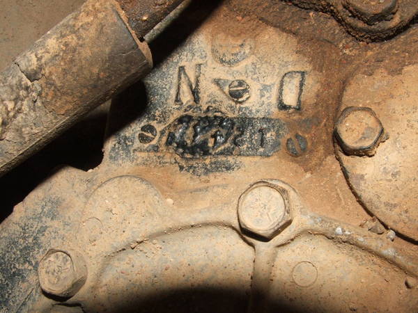

Buck, this is all I could find for a tag on my 205. The tag is below and to the left of the rear output shaft. I'd have to pull the tag to get a closer look/picture. It almost looks like it's partially melted?

Those are trans ID tags, not transfer case ID tags. There is no example of a T/C ID tag in the parts catalog.
The cross reference of T/C ID numbers to Ford part numbers is listed in Text, Section 70, page 6. Section 70 is for M/T's. The T/C's are listed here whether for a M/T or A/T.
The tag on the transfer case was put there by FoMoCo, will have a number like this example: D7TA-7A195-AA.
Ben, there are dozens upon dozens of different T/C ID numbers. So the chances of your ID number matching up with Bucks is miniscule.
