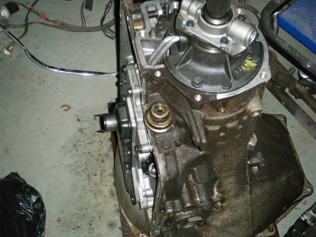

Whats the difference in the 2wd and 4wd C6 auto trany? I got loose from a guy that didnt know what it came out of. He was for sure its a C6 auto. I cross referenced the numbers on it and all I got was a 1976 F150/350 390 truck.
Here's the numbers on the trany.
PGB BN4 B19
D5TP TA 102364
9,461
301
waynesville,mo.
2 wheel has a tailshaft, 4 wheel doesn't.
This came off my truck which is a C6 mated to a 205...there is an intermediate housing about 6'' long that joins to the transfer case:
It sounds like a 2wd unit with a tailshaft.
