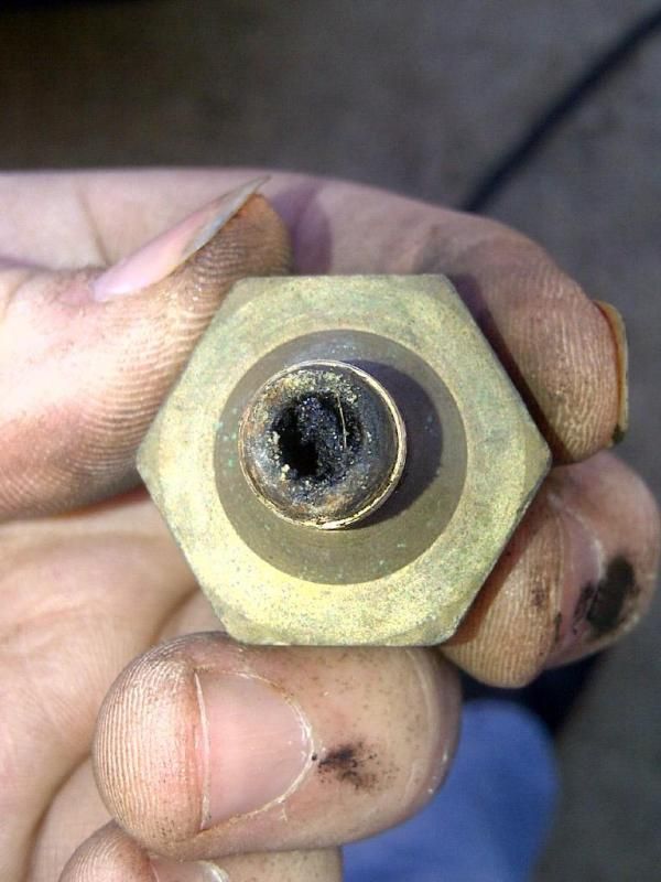

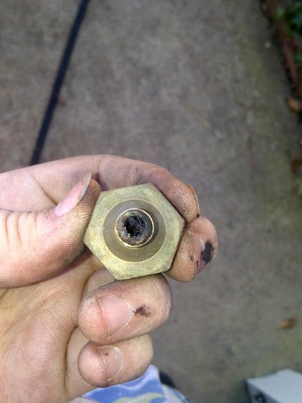

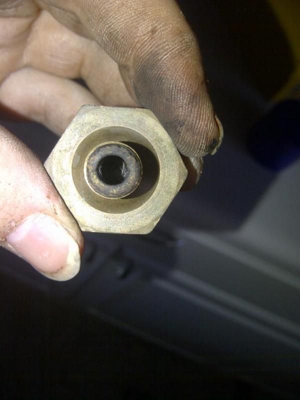

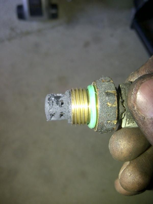

Pulled the back pressure sensor... doesnt seem to have been working too well... lol least i dont think it was...
was a little packed...
cleaned it out... also cleaned out the feed tube to it... had to use 100psi on it.. was something blocking it.. when it came out it popped like someone fired a small caliber pistol...

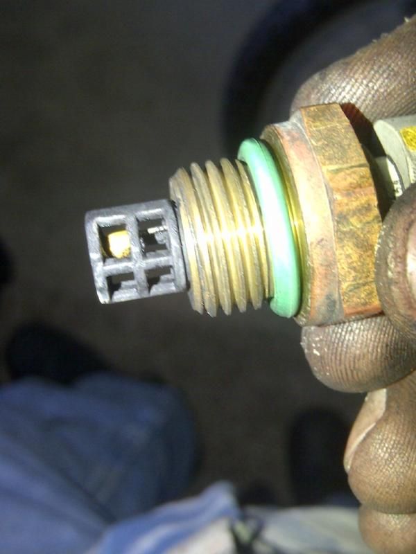

also pulled the IAT sensor... seemed a little gummed up...
cleaned it up as well...
