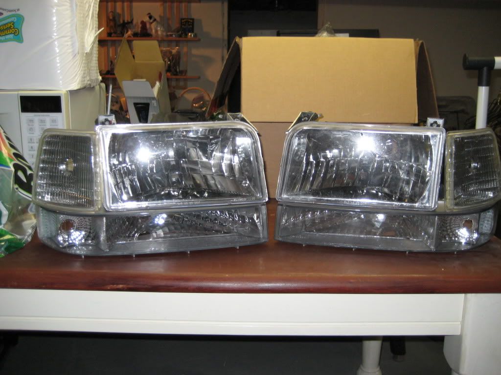

Yep any
93 -96 f150, Bronco , F250 (HD in 97 )F350 F450 till 97 .
Will work .

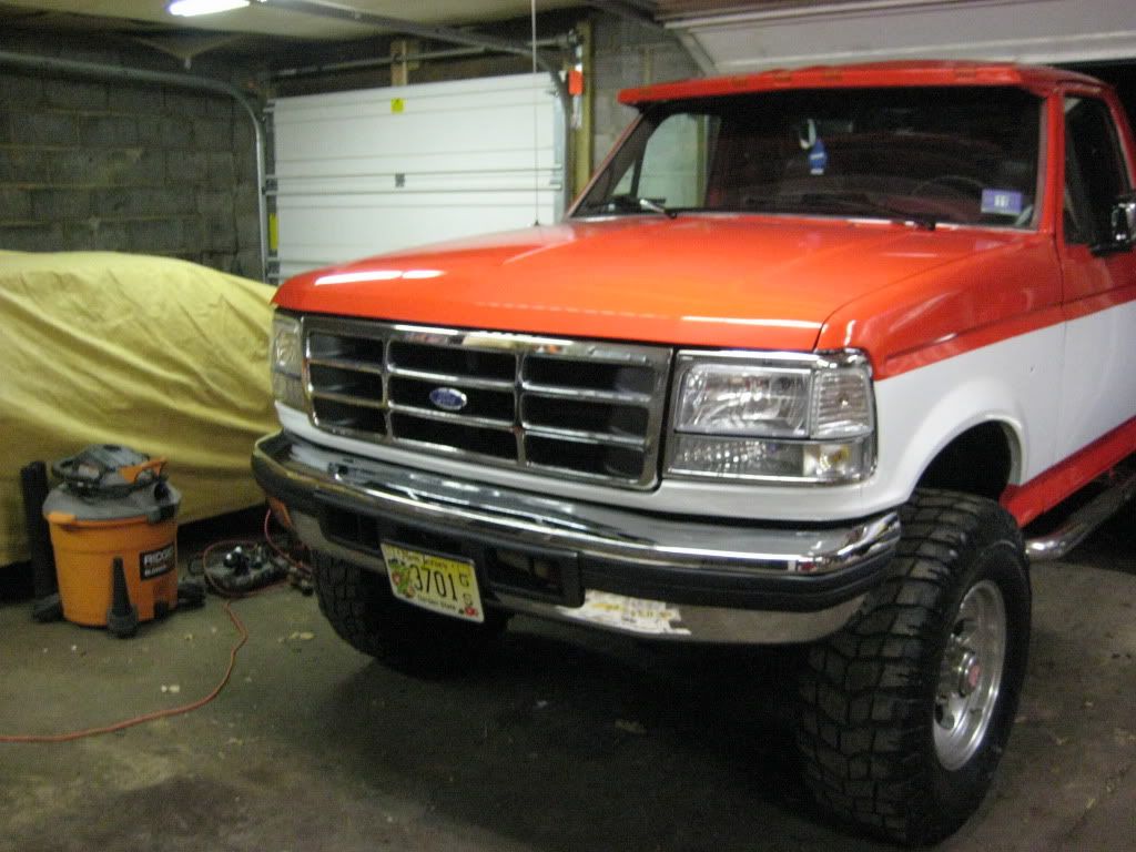

I got this kit on ebay for about 100 bucks give or take.
You just have to get the bulbs in amber, they are 194A and 912/922A, and the turn sig bulb is already amber, 3157A

I got those same lights chris! I need to get a new PS headlight still tho..
