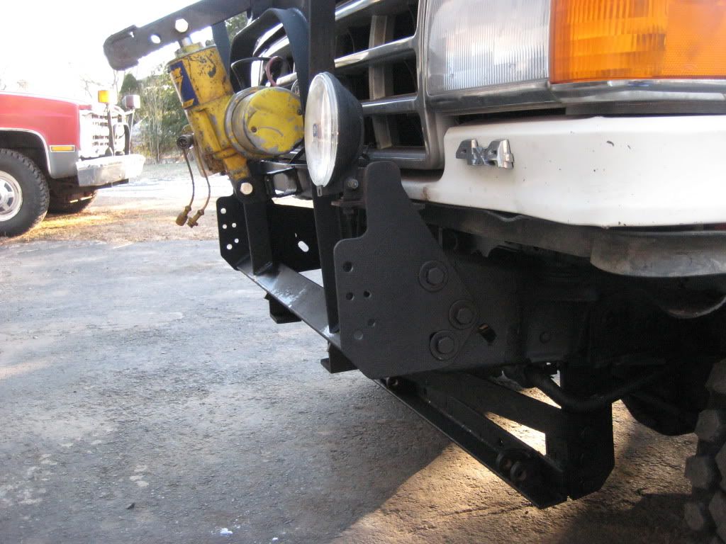

Yea so I decided that im not using the F350 to plow, as its too nice for work now lol. So I got a plow frame for the bronk, cost me 240, then I wanted to beable to use the F350 if needed, so I ordered the plow controls, and wiring for it, 220. Then I got the chance to buy a truck with a plow for 1G, its a 87 Chevy Custom Delux 20 with 65k on it, rotted the hell out, but newer plow blade, pump, and wiring, so I took that all from the truck. Truck also has brand new 235/85/16's on it, so im a swap some junk ones on it from work, and then sell the truck for 1G, caus Chevys are junk and this 1 is a POS.

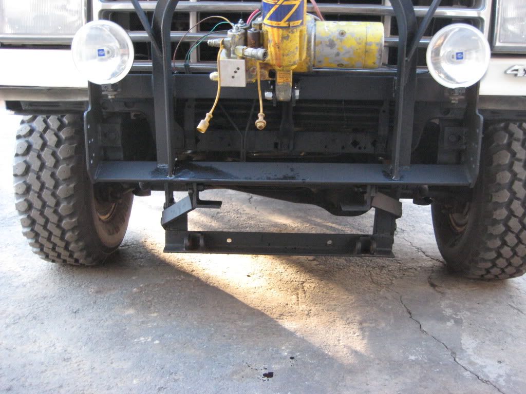

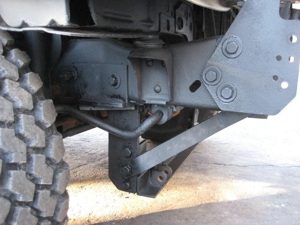

Wired it all up, put the frame on it, and yea now shes ready, ran into 1 prob, the left frame end was bent in and it was a pain to put the bolts in. When summer comes and I take all the plow stuff off, ill use the torch at work and get it straight. Pain to get the bolts in.
The pump was a funny story, my friend at a swap meet got 2 Meyer E60 pumps for 100 bucks, super deal even in unknow condition. Well he tired to get them to work, but only got 1 to go up, and the other one did nothing, so I was like I want 1, he tried to get 100 out of me, and I was like I dont think so, caus I fix all his stuff when he cant. Got it for 50 and I said id rebuild his also. Well I rebuilt the electric motor, pump, fixed all the broken valves and solonoids. And she works great. Well the kicker one, his one I went to rebuild today, completly trashed, was filled with water, and everything rusty inside it, hahaha he got screwed, hes gonna need alot of parts lol.
