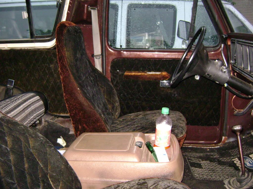

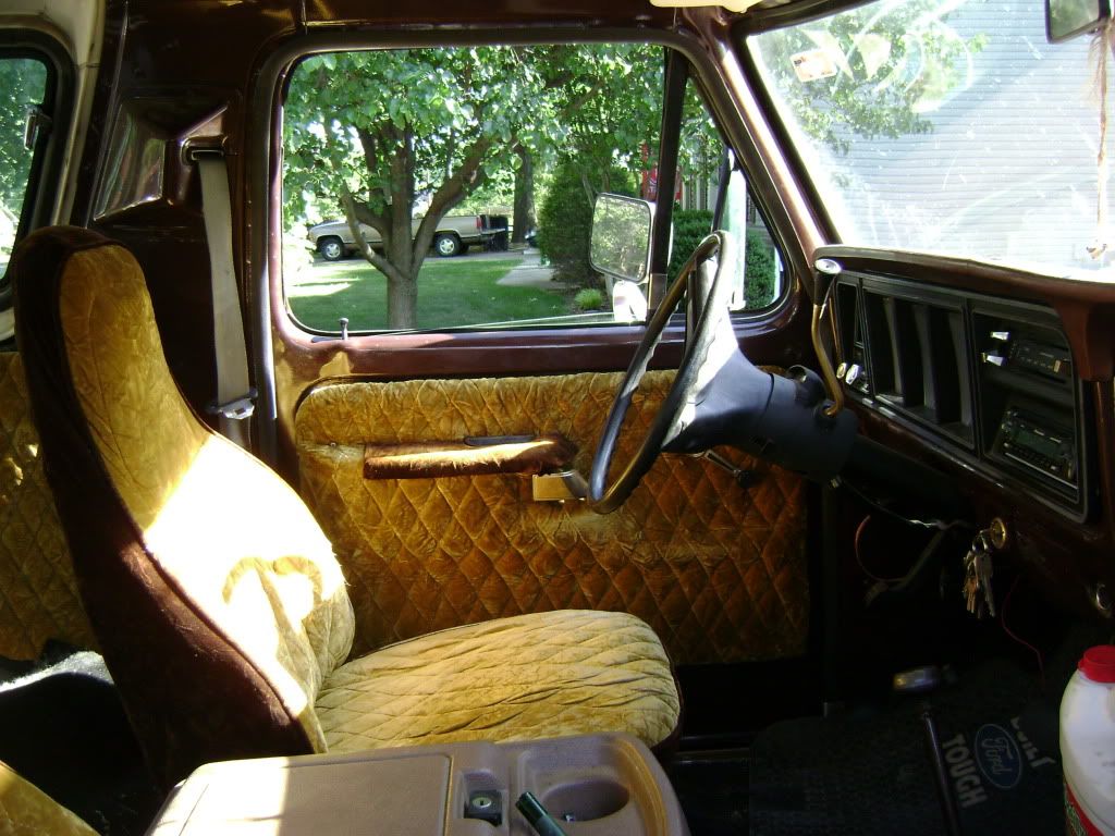

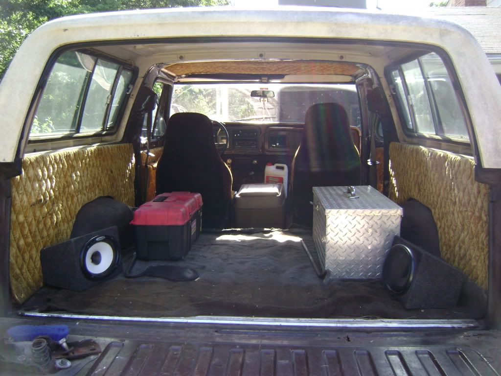

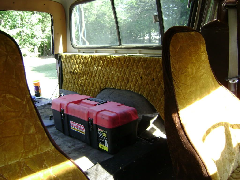

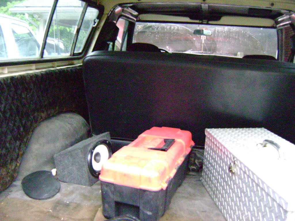

Let me preface with this did not turn out nearly as well as I was hoping it would. I grabbed some fabric dye/paint from Autozone and went at it. It was a little more sloppy than I anticipated and didn't quite penetrate the way I was hoping. I'm sure that could have been due to my impatience...or possibly the fact it's crushed velvet and not cloth. However, the old color really shows through with the light flash from my camera. In person, it's hardly noticeable. Either way, it's definitely a step up from the Brown and Gold...and now it's Brown and Black. I'm not entirely sure I like the color combo, but at least now anything and everything that WAS gold is gone. For an afternoon and $35 in paint/dye it was worth it. Here are the pics:

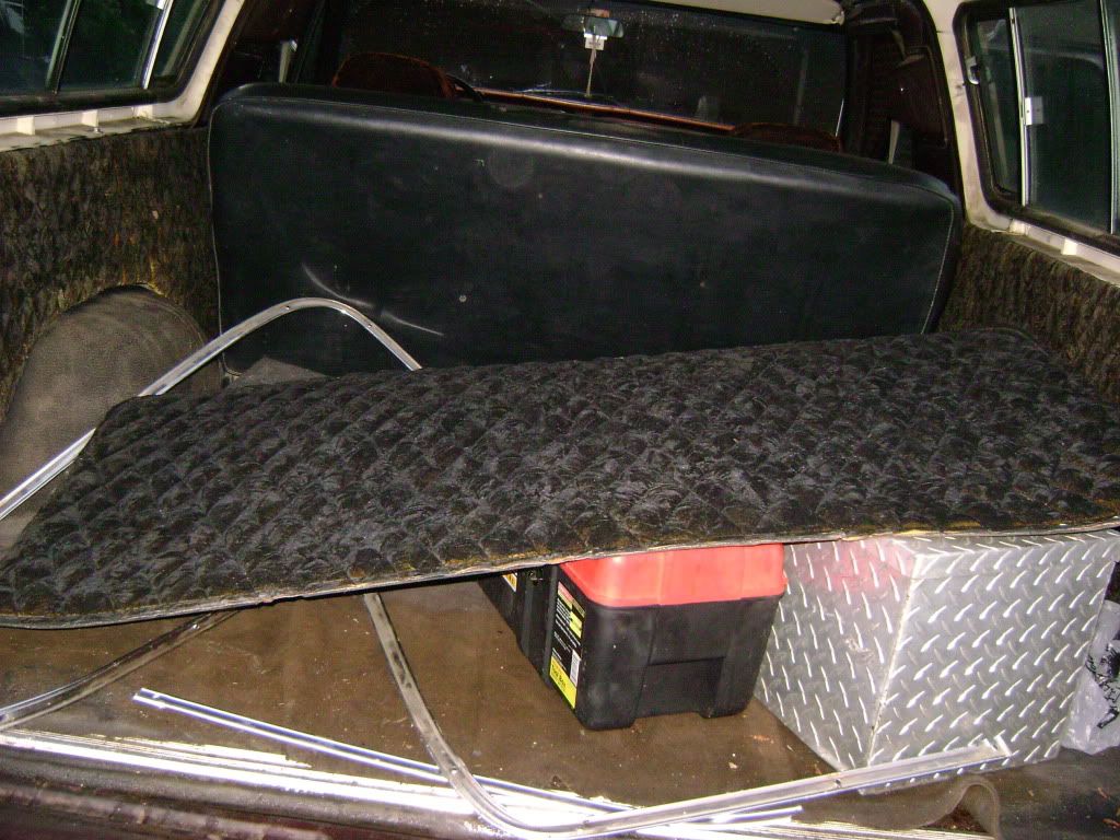

And for anyone interested, this is what the Eastwood Chrome paint came out like:
Regardless...better than it was, and I can always do it again.
Now I need to ditch the makeshift gray carpet in the rear. I was thinking of going with a rubber bed mat and cut to fit.
Well, I gotta say, the dark is better than the Puff Daddy Gold, lol!
Unfortunately the crushed velvet is synthetic, and doesn't take a dye very well. Any "wear" points are going to transfer outta there on the next pair of levis.
Unless they've developed a magic formula, you may be doing it again soon-
Not trying to cast a cloud on the deal- it looks nice, but I'd avoid the light color shirts for a while there-
If you wait a little bit and go at it with blue coral cleaner, whatever remains should be safely locked.
I like it, tho!
Thanks man...I actually used the same stuff I used on a seat I had in Red for about 3-4 years. But different seat materials yielded a better result in Red. But yeah, after about 6 months or so, you could tell the high traffic areas. By the time I swapped the seat out, those high traffic areas were all but back to the original color.
As for this blue corral cleaner...applied with a rag? Steam cleaner?
Micro-Fiber works best, since it's like brush bristles. I regular rag would just pass over and with Steam Cleaning/hot water extraction you risk losing the "set" or the texture of the crushed velvet. Use the MF with the spray when wet, then a dry cloth before you vacuum.

FYI...this was a terrible idea...well on the high traffic areas, like the two seats. The panels are still holding up really well. Hopefully either picking up matching XLT buckets or a grey captains from a '94 this weekend.

LMAO! That gold interior was full of the lulz.
Looked like a Detroit bus driver's mouth.
