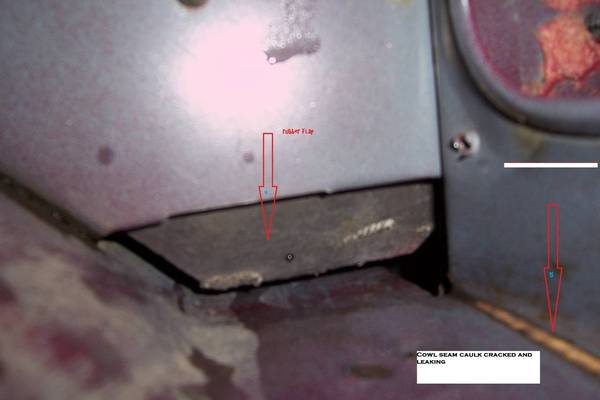

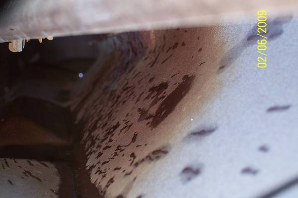

I slipped my camera into an access hole behind the clutch reservoir ,
so this picture was taken from the inside. It also shows the rubber flap that covers the drain hole and the caulking where it leaks. Here's an older picture of the bronco.

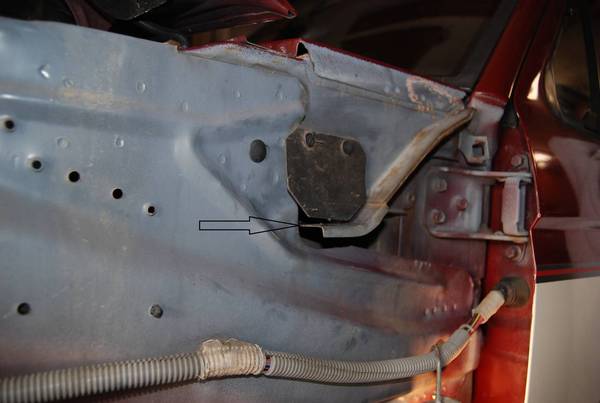

I took the drivers side fender off too see the outside of the drain hole.
when I ran water in the cowl I could see the water following the sheet metal back under the hood.
It would follow the edge back to where the firewall meets the side kick panel and get inside there too.

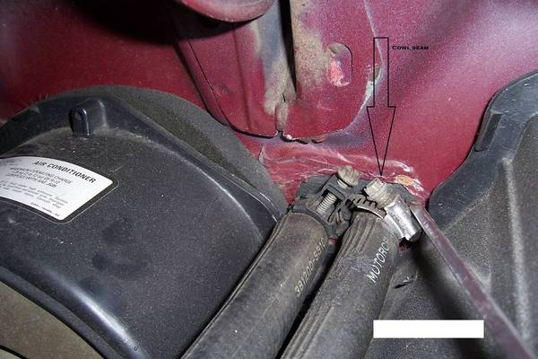

Here you can see where the water can run down the seam at the kick panel.

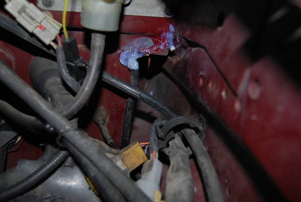

And also the leak between the cowl and firewall.

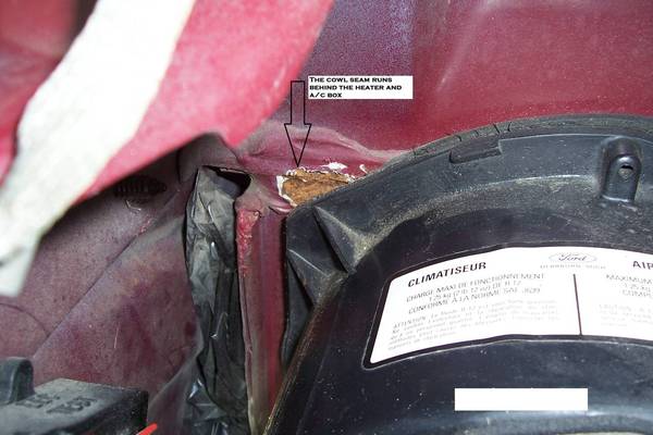

The cowl to firewall seam also goes behind the A/C, heat and fan Plenum's and can leak into the passenger side floor. When I parked the Bronco ,
it was leaning so that the passenger side was lower. Causing the water not to drain out properly, and leak here.

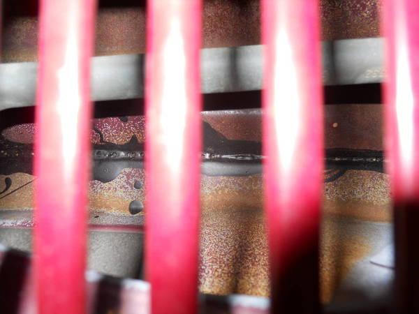

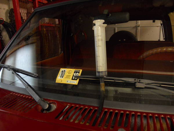

I stopped the water getting through the cowl to firewall seam buy injecting rubber sealant that I thinned out, by putting a rubber hose on a big syringe.
Through the antenna hole and the grate.

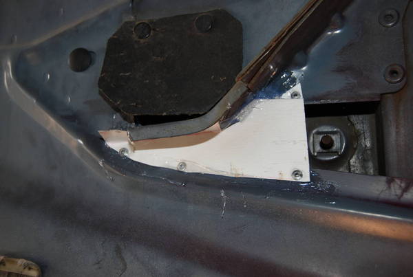

I stopped the water getting into the kick panel to firewall seam by blocking off the area below the drain hole ( behind the fender )
with a piece of aluminum and adding silicone to the seam in the engine compartment.
