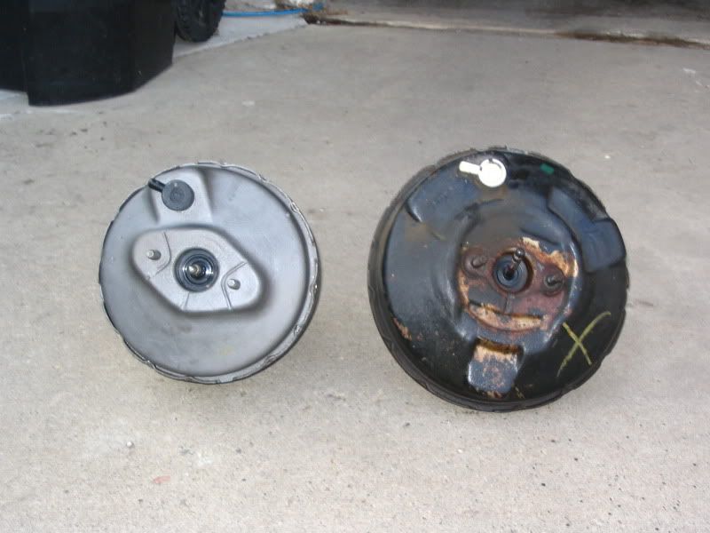

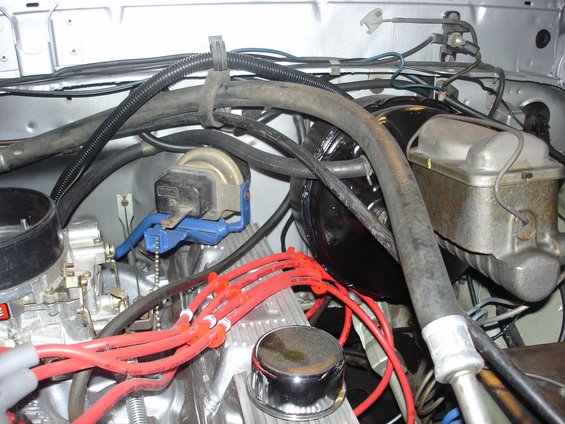

Yep F350 Booster.
Here's the 150/250 4x4 booster and the F350 booster side by side.
Another
he doesn't necessarily need the f350 booster.

It seems that the F350 term is a bit off. 460 booster is more of an accurate term.
I think that this booster can be found from the factory in any 460 equipped (from the factory) truck.
