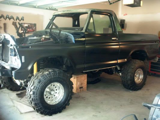

I hate to do this, especially a company that ive spent MORE than alot of money with, and a company that is based in michigan buuutttt....
When i bought my truck in April of 07, i put a Tie rod kit on my truck, Includes aallll the steering links and everything.
Well they didnt even last me 2 years. I had a bad knock in the front end of my truck, only knocked when i put it in drive (or reverse) and taking off really slowly. Didnt matter how bumpy it was, most the time the knock would happen when taking off on concrete.
I thought maby my rear slip joint was out of grease again, or a bad U joint which i inspected and all are good.
SO tonight i was doing my inspection before my 4 hour highway trip and sand dune driving, i jacked up the drivers side front end to check tie rod ends and ball joints, and to see maby if that knock was coming from the front (Which I KNOW it was coming from the front) as i could feel it in my floorboard when it would knock.
Drivers side checked out great! Checked the passengers side, ball joints good, check tie rod end and i have about a inch of play on either side, which im amazed im either still sitting here alive, and how its still connected, Maby, havent checked yet but its BAD.
If i have to change Tie rod ends every year and a half then this is going to get expensive.
But im going to contact Bronco Grave Yard in the morning and see what they think about this.
I regularly grease my tie rod ends. Alls i know is im going to be glad not to hear that knock again, makes me feel like im riding in a big piece o crap...

Every piece that i need new on this truck came from BGY. Its only about an hour and a half drive from my house, so instead of paying the price of shipping quarter panels and new doors, i just went and picked them up.
Everything in black except for the cowl was from BGY
To bad now i gotta make sure i got that stinkin tie rod end exactly where my old one came off at so i can take it on a vacation without needing an alignment..

Ok i wasnt really mad until ummm... NOW!
As i went to replace the new tie rod end with a new one.... I noticed that the outer tie rod end that connects near the steering box is ALSO bad. I was to busy to call today but monday morning they are going to get an ear full now!
Now i cant take the bronco on the dunes for the last weekend. O well i guess il take the superduty...
