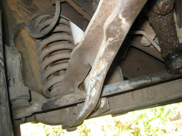

this is where the concrete hit

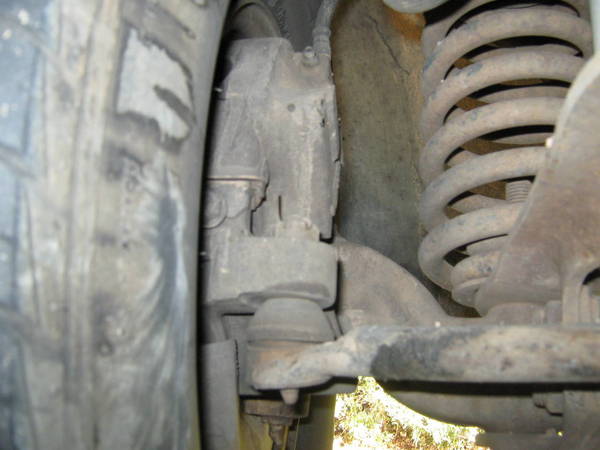

another shot... it's been a few weeks

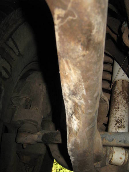

whatever that is
i took a bunch more pics but i don't know what i need to look at. i see NOTHING that looks freshly moved or scraped or rubbed or anything. that thin metal that i think is what y'all're callin the dust cover doesn't seem to be loose. i knocked on it and tried to move it by hand but i was laying in the grass with the back up on a hill which gave more space under there but still.... *shrug*
when it makes that noise i can feel it in my steering wheel too but i can't get it to make the noise after i've driven it any distance at all. i'll see if i can't get the sound too but i don't think i can. *shrug*
i'm going to load all these pics up on my photobucket and i'll put a link up to that so y'all can see if there's anything there of value... don't wanna overload the site with 20 useless pics ya know.
bucks77ford
We will Rise Again
2,409
101
Kasson, Minnesota
Nothing looks out of wack from those pics as far as I can see. If it only happens at a slow speed, maybe just take a floor jack and raise that side and spin the wheel to see what you get. Then, you could take the tire off and spin the rotor to see what happens.
