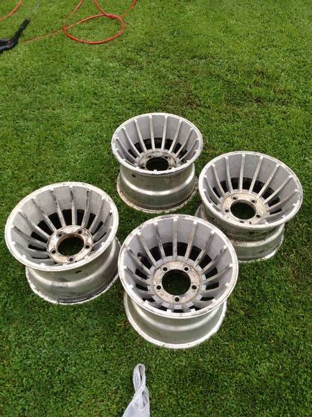

I started with these:

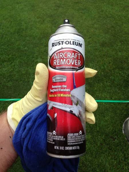

I used this stuff...found at autozone:
Use the gloves...I got some on my leg and its still burning an hour later after a shower.

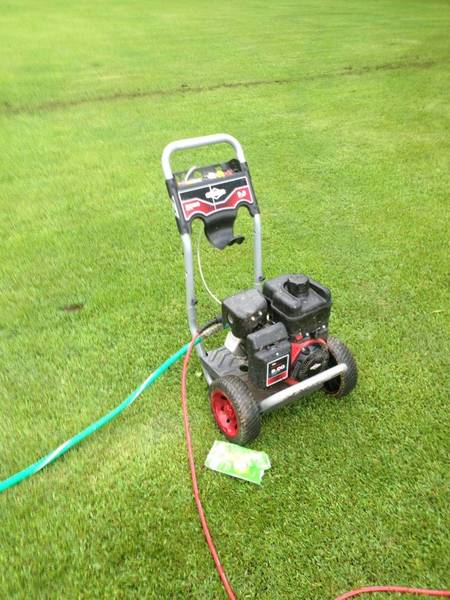

I also used this:

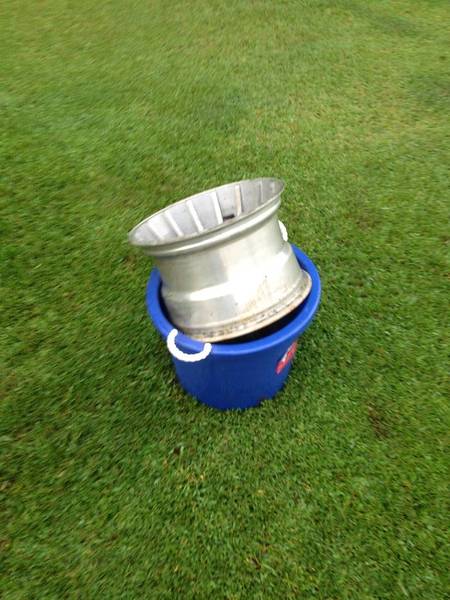

Here's my jig...hehe:
