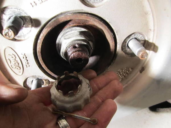

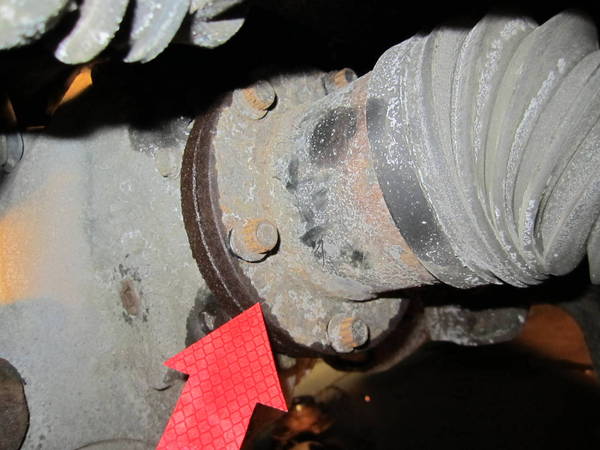

Before you raise the truck You will have to loosen the outer hub nut (36mm) and the six inner bolts (12mm twelve point) and of course the Lugs.

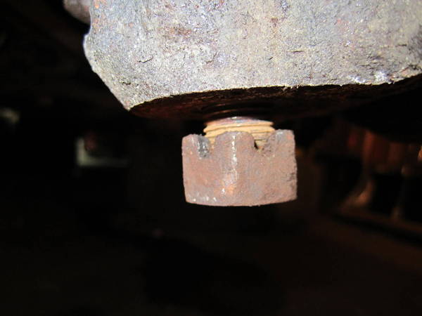

I like to reverse the castle nut like so when tapping out with a mallet.
But if your replacing the ball joint not really necessary. they make a tool for this, I don't have one yet.

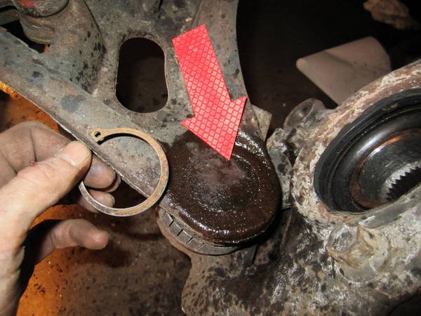

Tap out the tie rod(21mm) the upper ball joint(21mm)and lower ball joint( larger than 22mm I used a large crescent wrench)from the knuckle. The upper ball joint is part of the control arm and does not come apart. remove control arm (21mm) nut and bolts. Remove snap ring on lower ball joint and tap down out of the lower control arm. Once it is flush with the surface of control arm use a large nut to drive it down below the surface as to not damage the control arm.

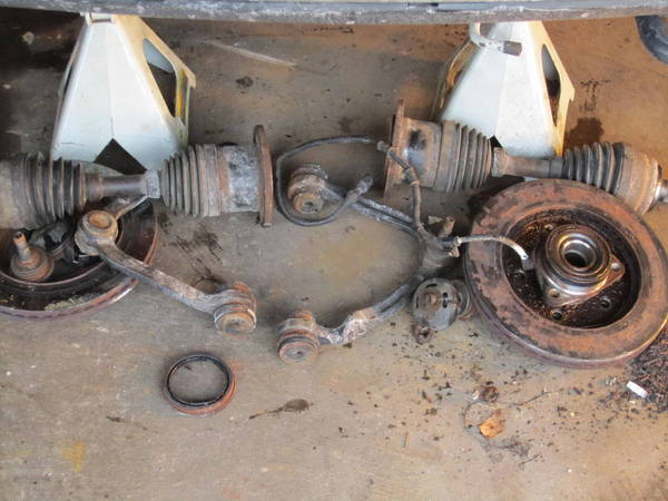

Since I took all this apart i am now waiting on parts to get here. I have kept all the old parts until the new ones are here and installed. I just set them up front somewhat out of the way.

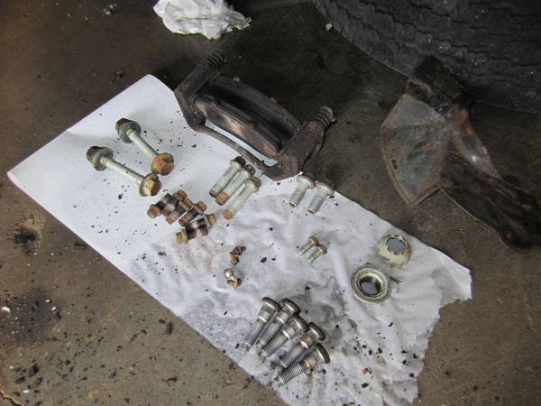

I also use a towel or paper to lay out all the hardware, brakets and such so they don't end up getting swept up or misplaced.

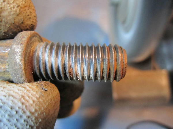

Also while waiting on parts it gives me time to clean all the nuts bolts and parts I'm reusing. While cleaning I noticed that the inner bolts for the CV Shafts have a tread locker on them, I will make sure to use some when putting back together.
