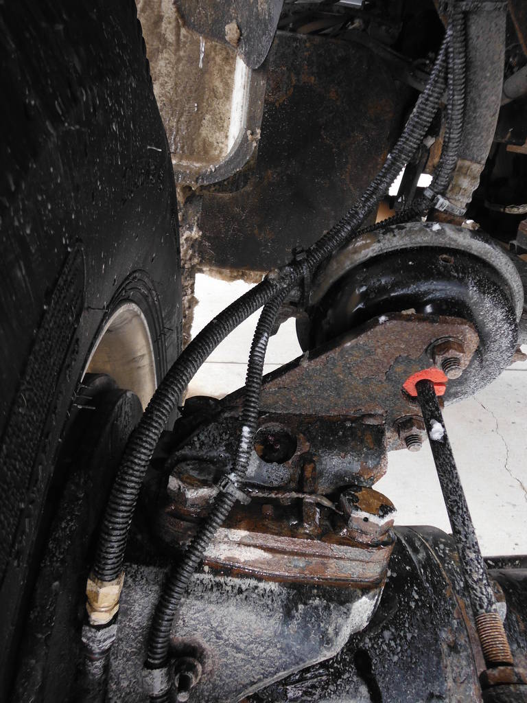

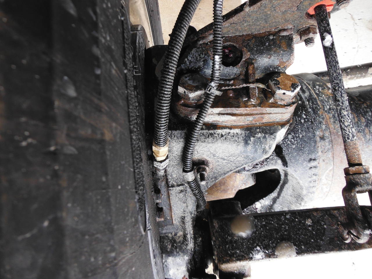

Hmmmmm.....it appears that the oil has been leaking from the vent tubes....which is kinda baffling as I did look there myself...perhaps I do need glasses after all.
When the planetaries get filled (2 qts) each they tend to blow some oil out of the tubes, it's done that from day one and you are advised to clean the tubes as a vicious circle of them having a reduced area to vent and pressure building up results in more oil expelled...you get the idea.
I have never bothered cleaning them as the oil stops fairly quickly....after talking with M-H this morning, we are figuring that the cold this year coupled with them being right made for a bad combination....the oil thickened right up in the cold....plugged the tube...then built up pressure and expelled the fluid...and of course being synthetic it runs brutally.
We will see what happens.

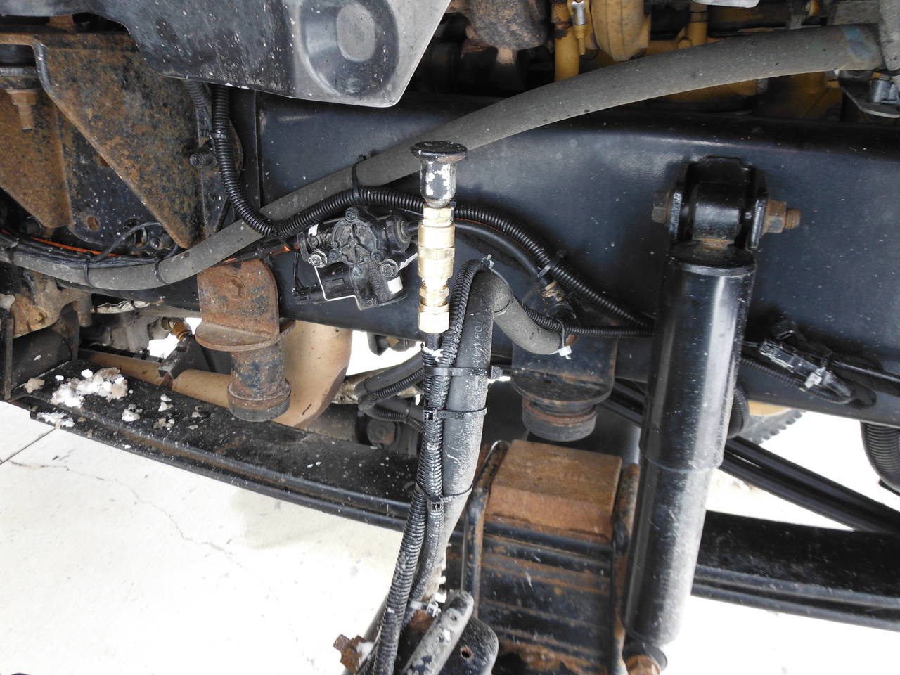

Vent tube have been modified and 18'' added to them, we will see if that is/was the problem.
Just drove it home and there appears no leaking.
Air dryer was cracked where the intake line attached, real hard to see it even when it was out on the bench.
The mystery flickering CEL is still a mystery, getting an immediate code of low current on the intake manifold heater, I will investigate.
Where the brass fitting is in this picture is where the vent top (above pic) was.
