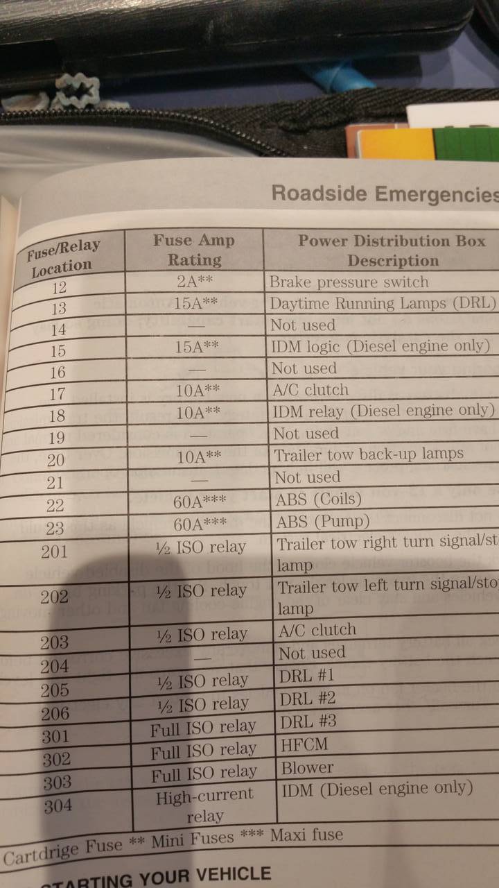

On my last truck (97 f250hd) I had a backrack with a pair of halogen lights mounted to it. I had them wired up with a relay and a spdt switch in the cab. For the reverse light signal I tapped into the trailer reverse light wire as it excited the relay box under the hood. So that I would only have to run one wire to the backrack and not have to run it from the back of the truck.

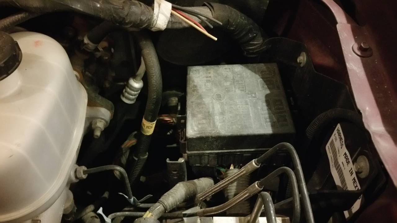

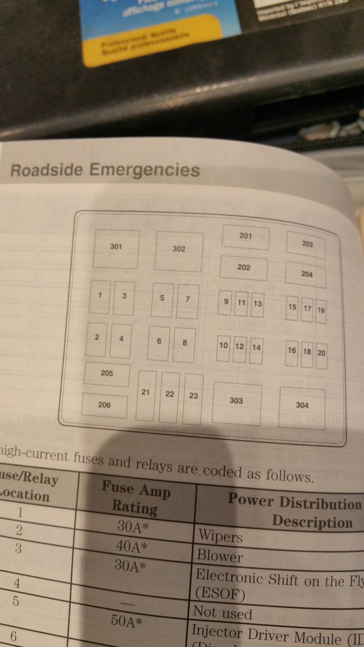

I want to do the same thing on my new 07 f350, but I need to know where to pick up my reverse light signal. Is there a relay box under the hood on this truck? And which wire, on which relay do I need to tap into?

Gimme a bit and I will go and look at my 05, which I believe has the same wiring layout.
I just called a buddy with an 07 and he said he has a relay box in the same place as mine 05, so I am assuming that they would be the same.
The upfitter switches were the same for 07 as 05.
No problem!...I thought I had an actual diagram but it was for my big truck..in any case, hope it helps!
