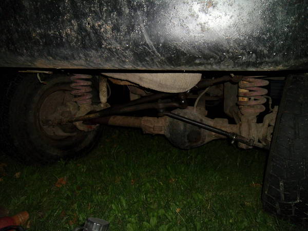

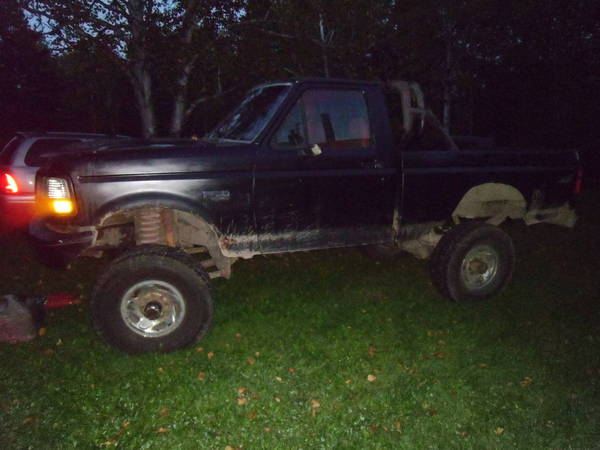

So a week ago this past Saturday I was over at my buddies house. He is in the scrap business. He said he had just got in a 92 F-150, and I should take a look at it. So we wander back to his junk yard and I`m expecting a 4x2, Custom, 300, rotted out pos.
Oh, it`s got a 300, and a 5 speed. But it is a 4x4 that has been converted to straight axle with a 76 F-250 front axle, full floating sterling in the back, and a whole bunch of, I`m a fabikater, fawktard crap going on. It also had a rust free cab, which is a big deal in my neck of the woods, and in my eyes.
It was driven in, and because I don`t have enough projects, and I have truck ADD, and we are bros, I got it for 4 hundo. And yeah, he made at least a hundo on it. So how about some pics, and then some more story?
It was getting dark, as you can see, and then the camera died, otherwise there would be more pics of the awesomeness that was done to this thing. I gotta make some dinner, I`ll post more tomorrow.

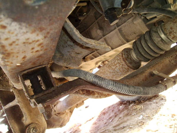

Holy crap. Where does the time go? How about an update? It ain`t much of one, but it`s something. I`ll at least show off some of the horse crap that is going on with this truck.

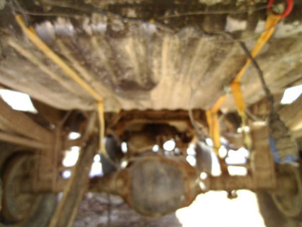

Why bother with bolts for the fuel tank straps when we have ratchet straps?

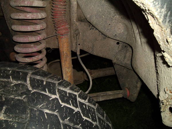

We were able to weld radius arm tabs to an F-250 axle, but we will just throw some spacers in here for driveshaft clearance.

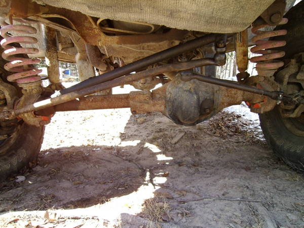

Still got the TTB steering linkage on it.

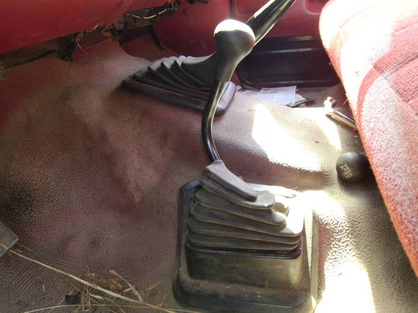

There is more, but things have changed a little around here, and I`m a little slow at figureing it out. But hey, I worked on it this weekend! The t-case shifter was gone (big surprise there), and a truck finally came thru the junkyard that had one.
I swapped out the inverted y ttb steering linkage for the correct for a solid axle inverted t steering linkage. It was toed out about two inches.
Ok. So they used a 76, early 77 F-250 front axle for this. What that means is low pinion, disc brakes, and external lockouts. When they welded the radius arm tabs on, they tipped the pinion way up to help the driveshaft angle what with all the lift. Hence, no more castor.
They also used ttb lift coils, which are way stiffer than solid axle coils, and ttb radius arm drop brackets, which is fine, except they put them in the ttb position, and lopped a foot off of the straight axle radius arms. That took me a couple days of eyeballin to figure out, lol.
So between the stupid stiff ttb coils, and the two extra leaves in the rear springs, this thing rides worse than my blue truck. It`s bad. And with the front end being toed out, and the castor being wiped out, it`s scary to drive. And I haven`t had it over 10 mph.

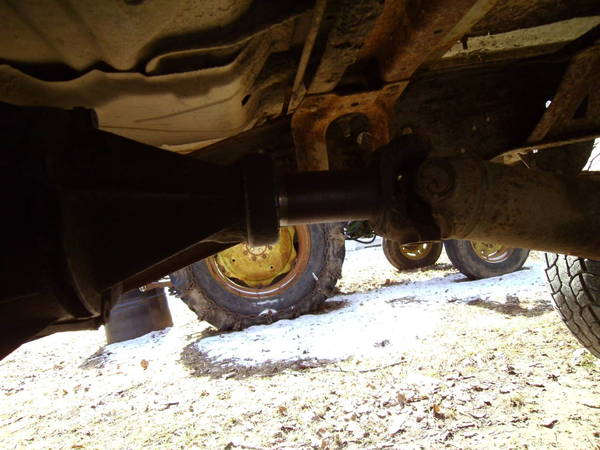

It also needs a longer rear driveshaft, the track bar is to short, and it needs a fuel pump, and a water pump.

But hey, it has a t-case shifter, and better steering linkage. Which turned out to be a bigger pita than it should have been, lol.

I also know who he had work on it after he got it, before it ended up at my buddies. Yeah. He thinks he`s a mechanic, got a "500 hp Cummins" painted like a Monster can to prove it. He wouldn`t know an honest real 350 hp if it ran him over. The fuel tank proves it. One strap still hanging from the crossmember, the other throwed in the back of the truck, and ratchet straps holding the tank in. WTF? You could`nt fish thru your junk and find some crappy bolts? But I digress.
Funny story. Shortly after I bought this, the fam came over. Mom, stepdad, sister, and her boyfriend. Sis says, "Hey bro, can I drive your monster truck?" Well sure. So I get it running (fuel pump not being all it can be, remember). She tools off across the yard, up the drive, turns onto the private road that leads to the rest of our property, and proceeds to floor board it, bang second gear, and go bombing down the road for a quarter mile. Turns around and does it all over, lmao. Of course we can hear this because it has only two little pipes coming off of the manifolds, and the the whole time I`m cringing, hoping she does`nt blow the rear driveshaft right off, because that`s WAY too short, lol.
