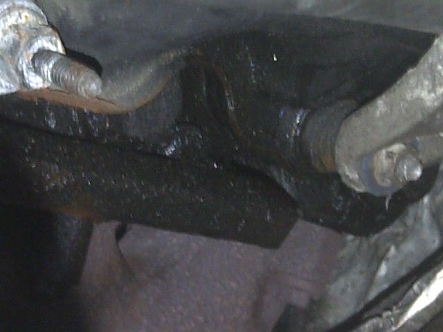

could be.. cant say for sure but probably... they were saying theres a small valve cover that sits on top where the FICM sits.. then a lower one under another cover that bolts to the head.
i can only see the driver side from underneath.. but the leak that keeps running down here seems persistent.. ive have the valve cover gasket done twice and assuming they only did the upper one maybe??

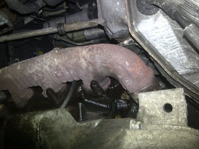

stuck the phone down in where it could see what i thinks the glow plug.. hope thats what that is.. cuz didnt look like the other pics people had..
so does that look more like the VCG or glow plug leakin?

looks like it.. but couldnt reach it...
