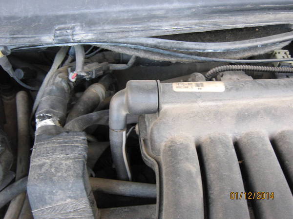

Look on the back passenger side. Theres a vacuum hose (pcv hose), its larger on one end than the other. Wish I had a dollar for every one of those I've replaced because of a vacuum leak.

Well now...that was stupid simple. Thanks for the help guys. The top intake gaskets were squished flat and the lower were worse than flat. Now it idles at a perfect 900ish and the CEL is gone.
FYI Vince...the old man replaced that line last year when the car was having vacuum issues...to pass inspection.
I actually just started tearing in to it...but when I couldn't remember where everything went...then I cracked it open...haha.
