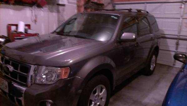

this truck will not start /only has fuel pump supply voltage to driver in the run position it drops off when cranking and after . tried by passing fuse and relay
there are codes for the fuel pump control circuit p025A short or open / code for vats B10F1 key in switch short to ground /replaced switch . code for air bag B00A0 -54 / also by passed driver module to get pump to work
cant find any harness issues or connector issues
