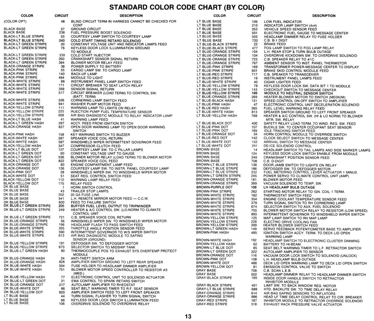

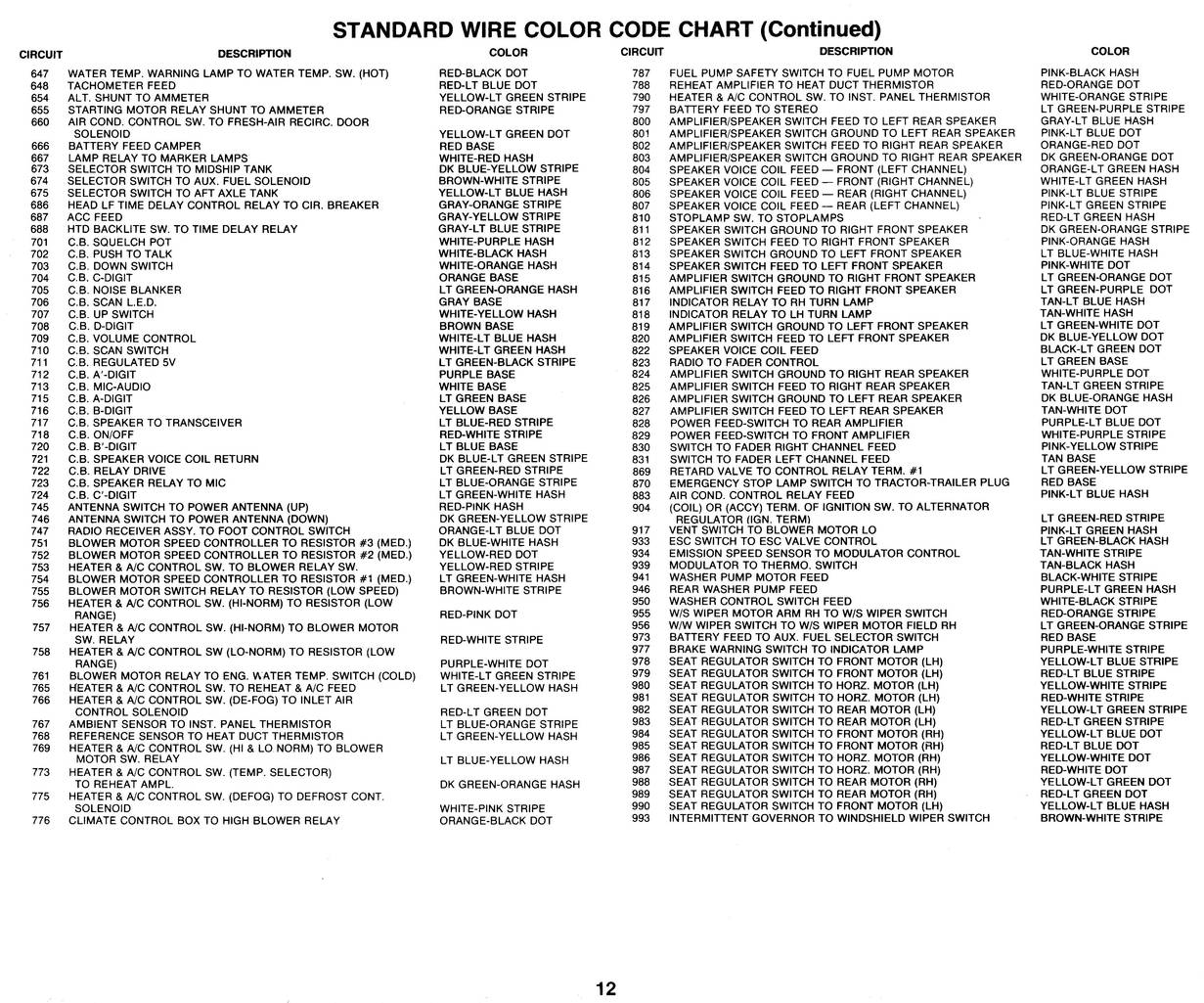

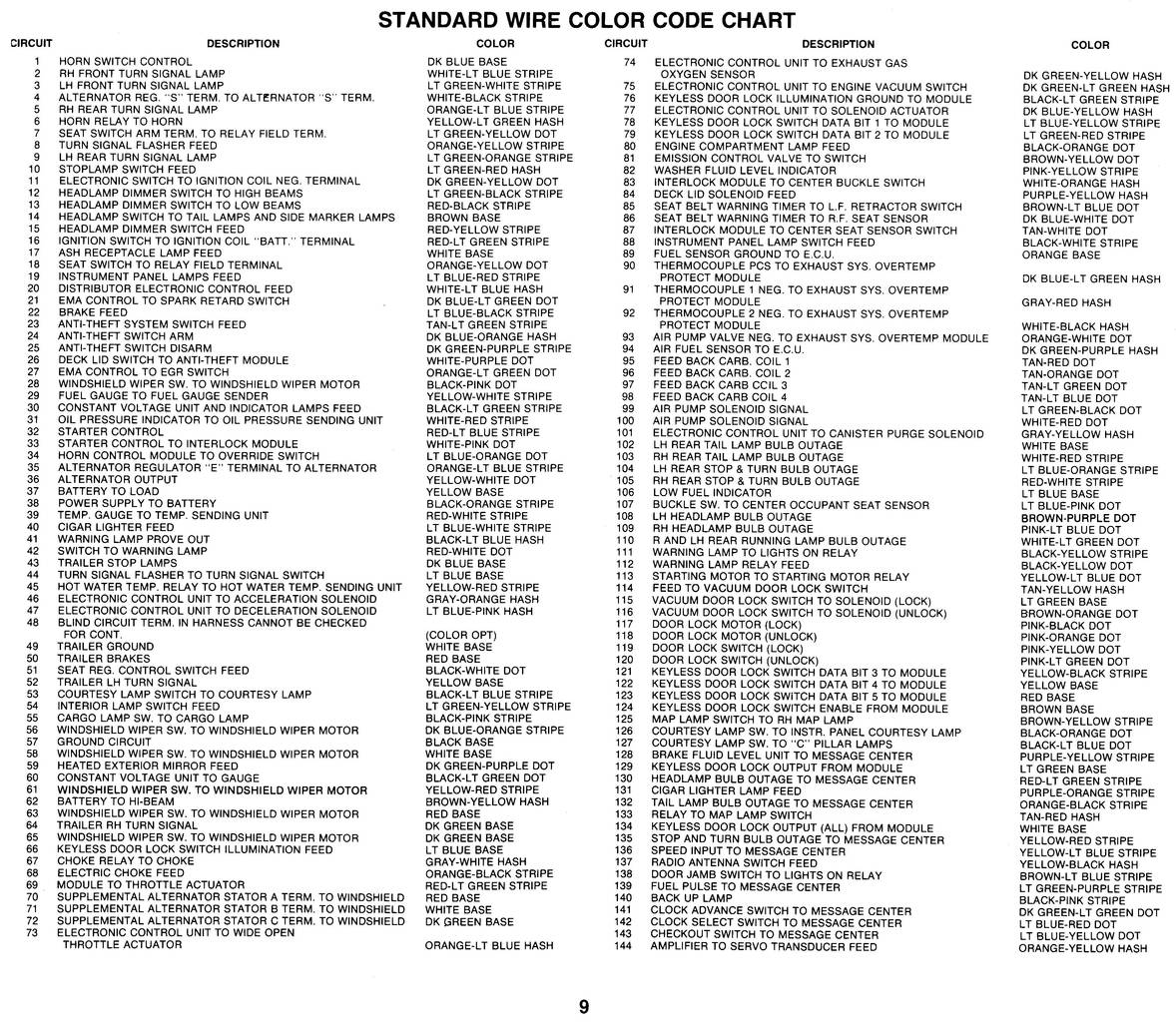

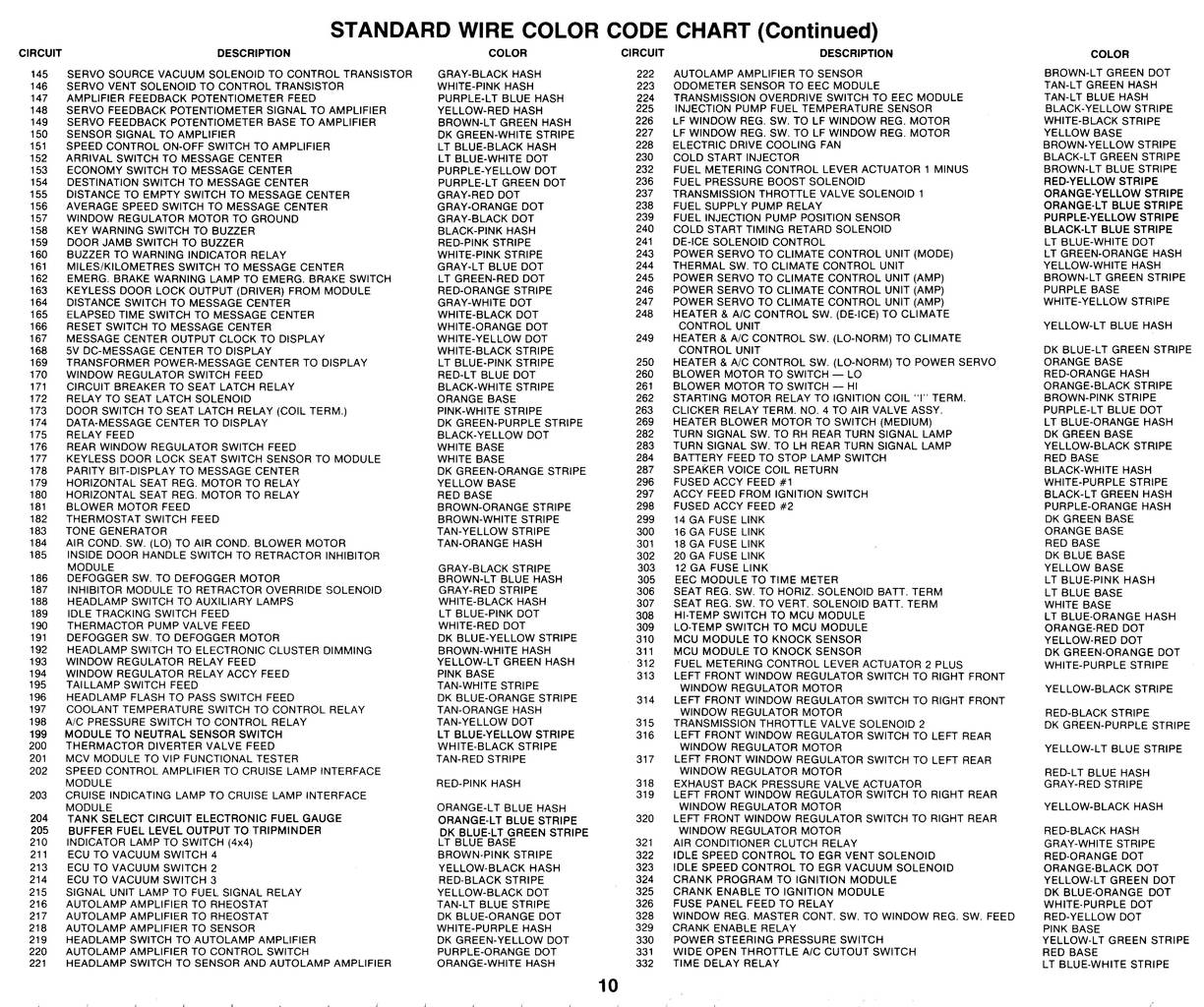

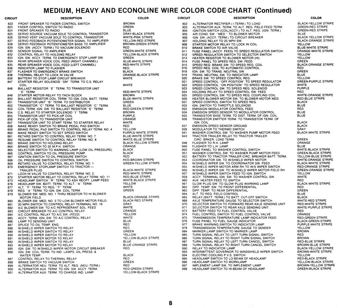

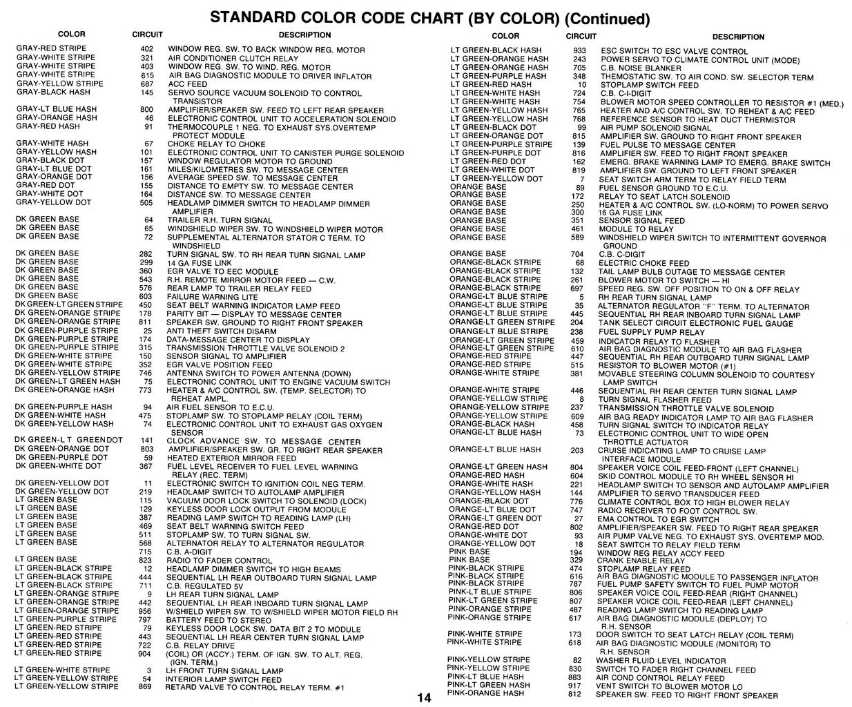

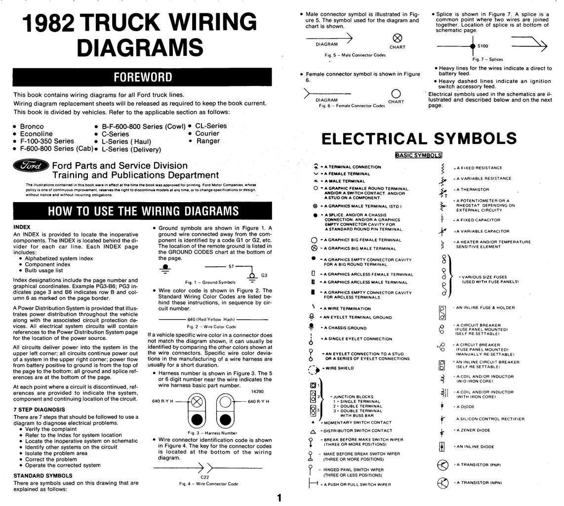

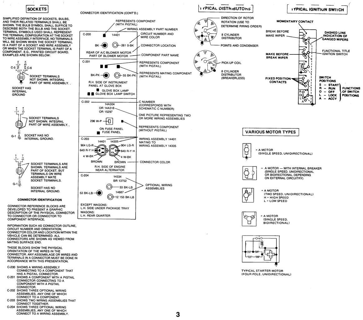

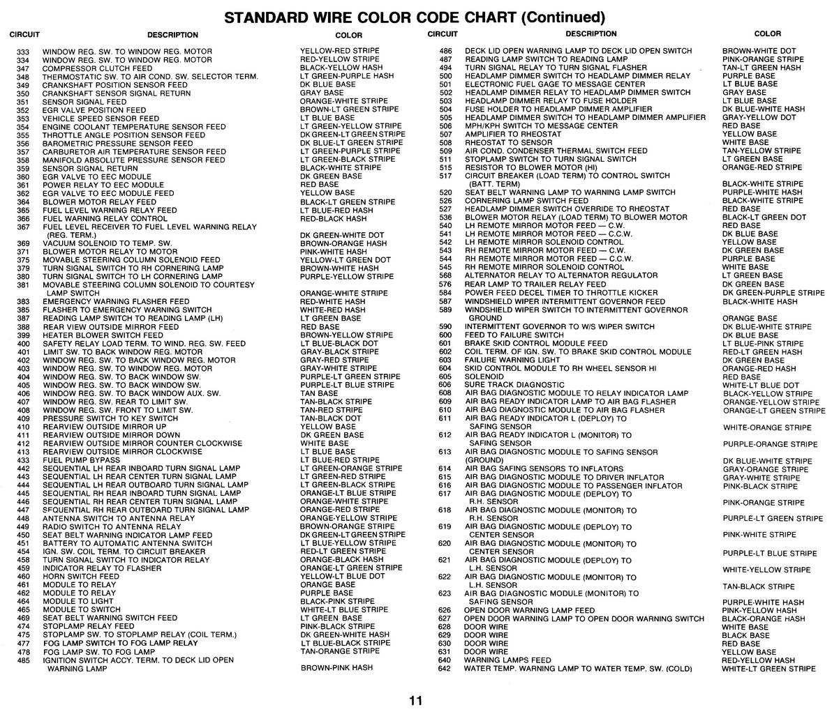

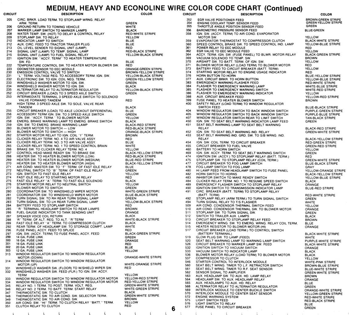

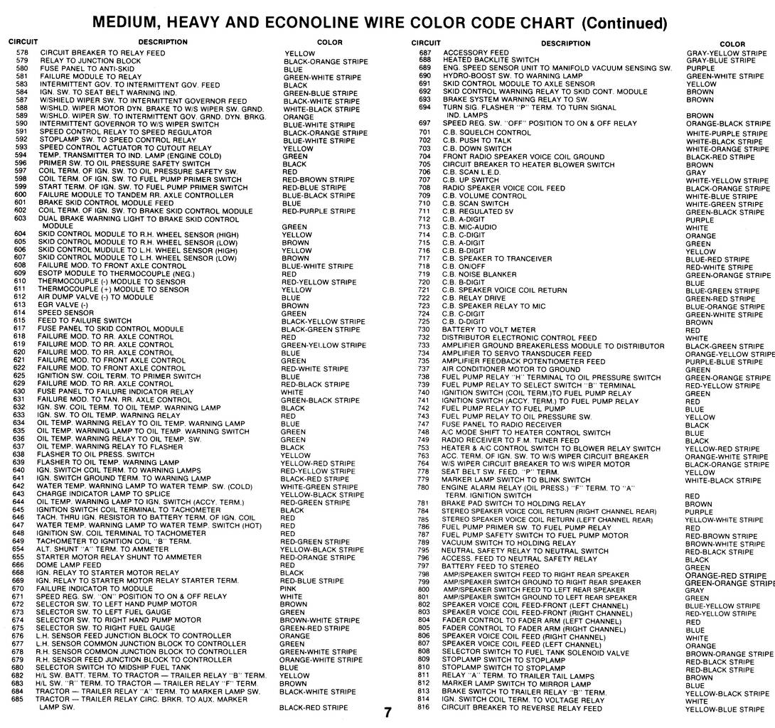

After the initial pages posted, there is a link to the site here for viewing the the actual diagrams. It had to be done this way to be able to view them clearly.
See what page you need from the index and replace "index" in the address bar with the appropriate page.
Open to feedback as always.
