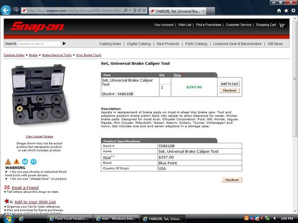

The tool to compress the caliper pushes at the same time turns the piston. Notice the "slots" in the piston? Thats what the tool engages to do the turning.
