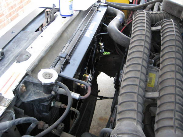

Step 1: Figure out what needs to happen.
The shroud and fan are in place and take up almost all of the room in the front of the engine bay. In removal, you'll have to figure out how to remove the fan from the pulley and remove the shroud from the engine bay.
That's what it looks like before...

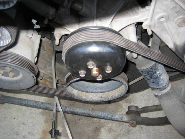

Step 2: Remove the fan from the pulley.
The fan has 4 bolts attaching it to the pulley. The four bolts that need to be removed are the ones pictured. Save these bolts! You'll need them soon.

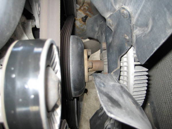

Step 3: Remove the shroud and fan.
These two parts are a little bit of a handful when removing them. You may find it easier to take them out together since it's such a tight fit. I was *barely* able to sneak the fan out from under the shroud and it was easier for me to handle them one at a time. The fan fit by pushing the shroud as close to the engine, and pulling the fan out the side closest to the radiator.

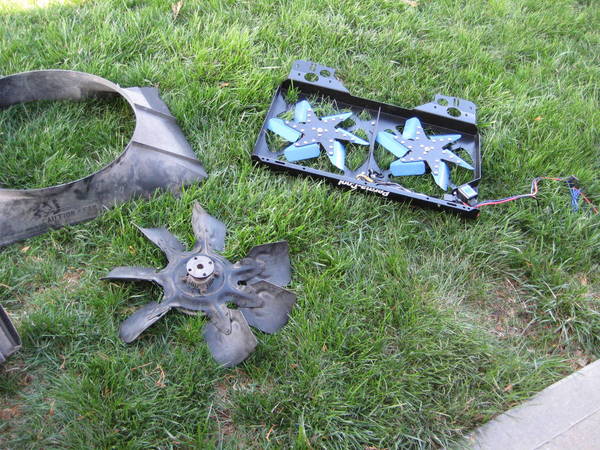

Step 4: Admire the parts
The old parts are historical and admire the new fan. You paid enough for it to stand there in awe for a few minutes.
