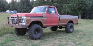

i guess i'll do a build thread, not sure where to start. i won't be doing a frame off resto until maybe next winter. need to find another vehicle to use as a dd before i can go too deep into this one. for now i'm just going to replace the front clip, fix the electrical issues, and replace a few things.
yesterday i had to fix the brake booster vacuum line again this time i made an extension for the clamp to give the ling a better angle so it wouldn't split again, also made a block off plate for the egr valve.

this is going to be a slow build as i am going to school and don't have the time or money for everything right now.
