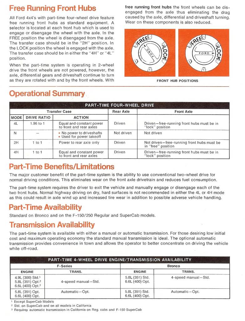

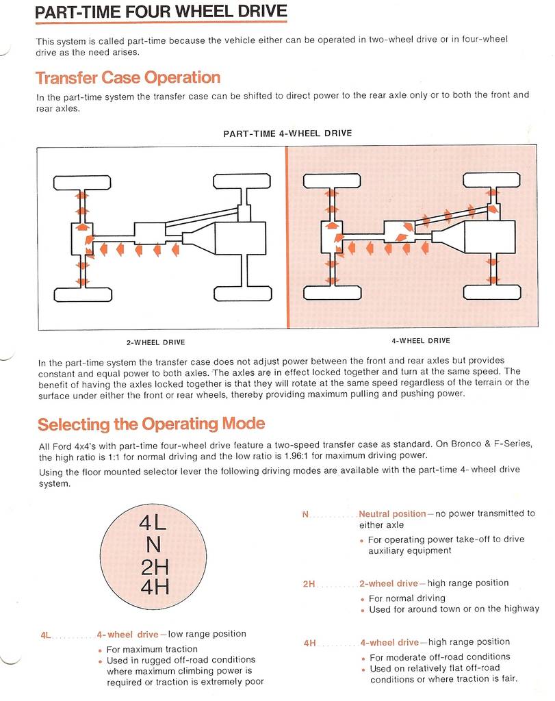

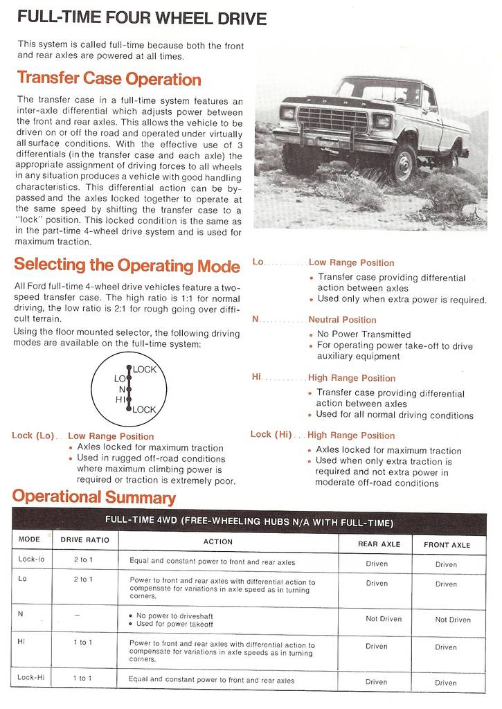

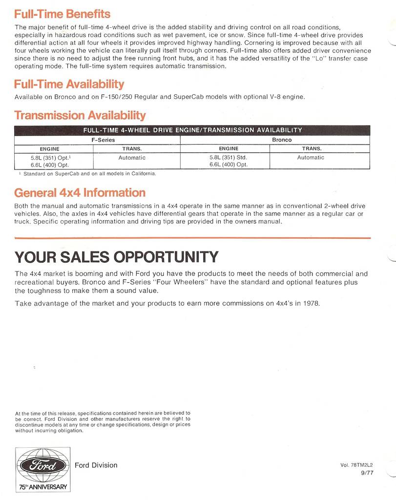

Why no limitations on the full-time system? But a question I've always had...is how was binding prevented with these full time systems? Never messed with a truck that had a 203.
Because there is a differential within the transfer case...so imagine the transfer case being the pumpkin and the front and rear axles being the left and right wheels.
