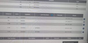

There are 5 dealers in the us that show they still have in stock. Crappy pic but the phone numbers are there. You could give them a call see how much to ship to you.
