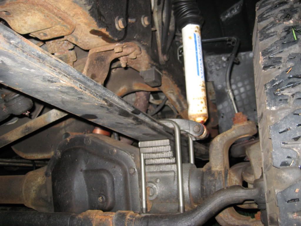

So I picked up a Leveling kit for the truck, 2.7" in the front, and a 4" block for the rear to replace the 2" that is there. My rear already has the 4" and an add a leaf, so it sits really high already. Front was way too low. Kit was a bit of a pain, and i know i am going to need a drop track bar bracket or longer/adjustable bar, and longer links.
So the Kit was installed with the F550 front leafs I already put in a week or 2 ago.
Also installed BDS front shocks, I did get a pair of skyjacker shocks at the swap meet Saturday, so I will be swapping em out, to match the rear Skyjacker shocks that I installed Friday night too
Ill try to get some better pics soon
