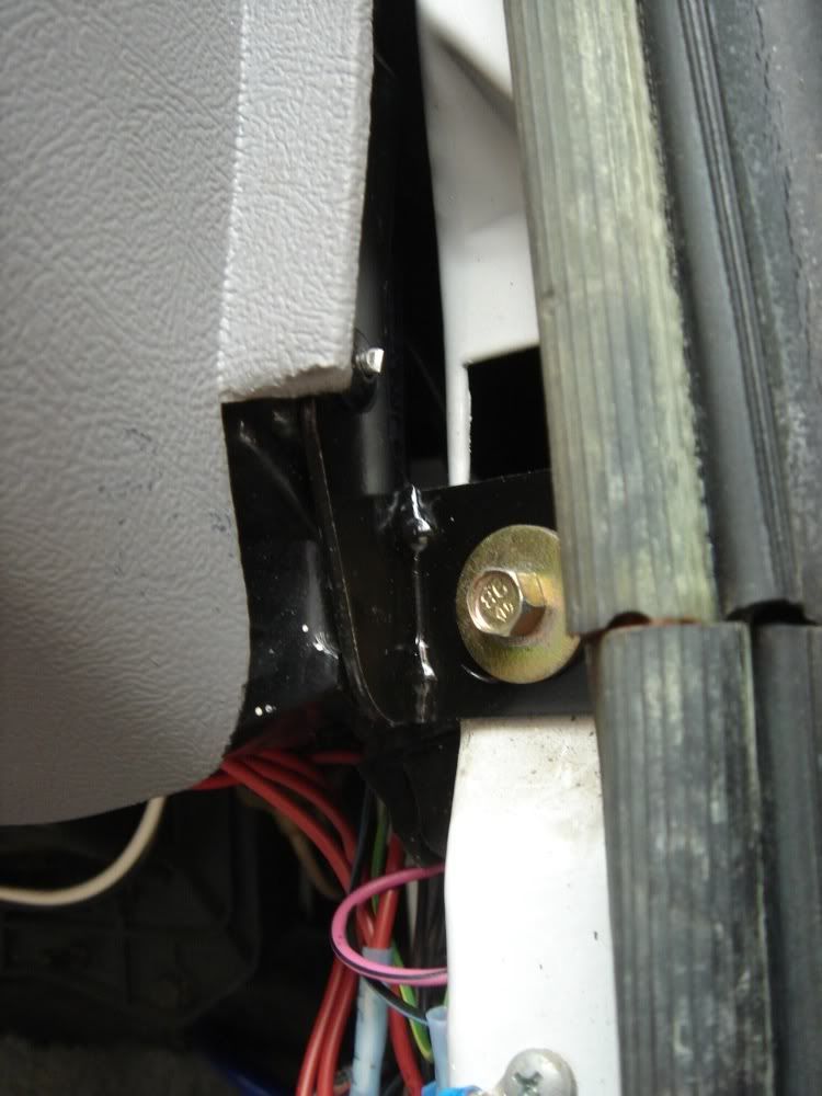

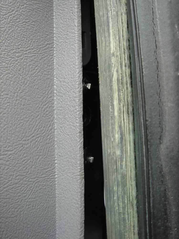

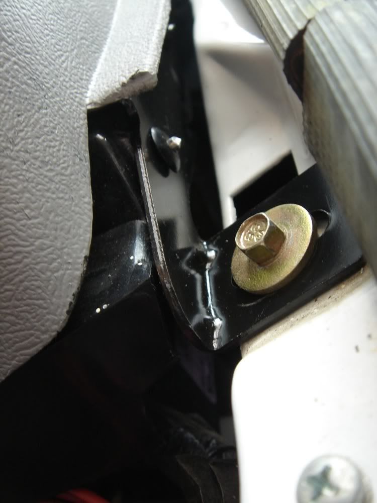

Had the kick panel off yesterday for my woofer installation so I figured I'd snap a few picks of said bracket. It's kind of hard to see when the dash it screw back into place, but at least you can see the quality of the bracket and how it's riveted to the dash all the way up:
Great pictures, there, Chris!
